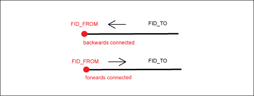

FID_FROM |
Specifies a particular feature. |
| F_CLASS_ID_FROM | Specifies a particular feature class. |
FID_TO |
Specifies the connected feature. |
| F_CLASS_ID_TO | Specifies the connected feature class. |
FLOW |
Specifies the flow direction between a particular feature (FID_FROM) and the connected feature (FID_TO).
