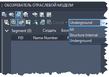

Using Infrastructure Administrator you can customize the Electric Explorer by creating profiles that display only the containers you need. For example, a Transmission profile would contain poles, towers, conductors, and devices but not ducts. An Underground profile would contain conductors, ducts, and devices but not poles or towers. You can make profiles available to different user groups. To create Electric Explorer profiles, see Create Electric Explorer Profiles.
To change Electric Explorer profiles
