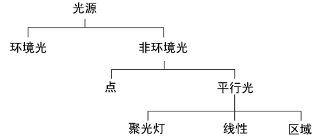

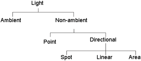

The light classes are derived as follows, where a class inherits the functionality defined in the class above it. The user can only instantiate ambient, point, direction, spot, linear and area lights.
For directional lights, the light positions are (in Z-up coordinate system) position at (0,0,0), view at (0,0,-1), and up at (0,1,-1). For linear lights, the axis by default starts at the position point and extends (2,0,0). For area lights, the short axis starts at the position point and extends (0,1,0); the long axis starts at the position point and extends (2,0,0).
