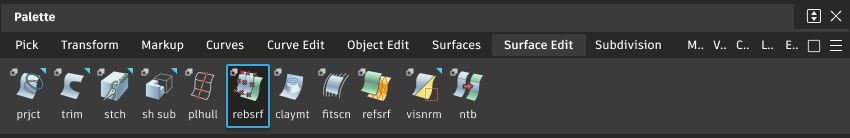

从“Surface Edit”工具箱访问此工具:
“Rebuild Surface”选项
