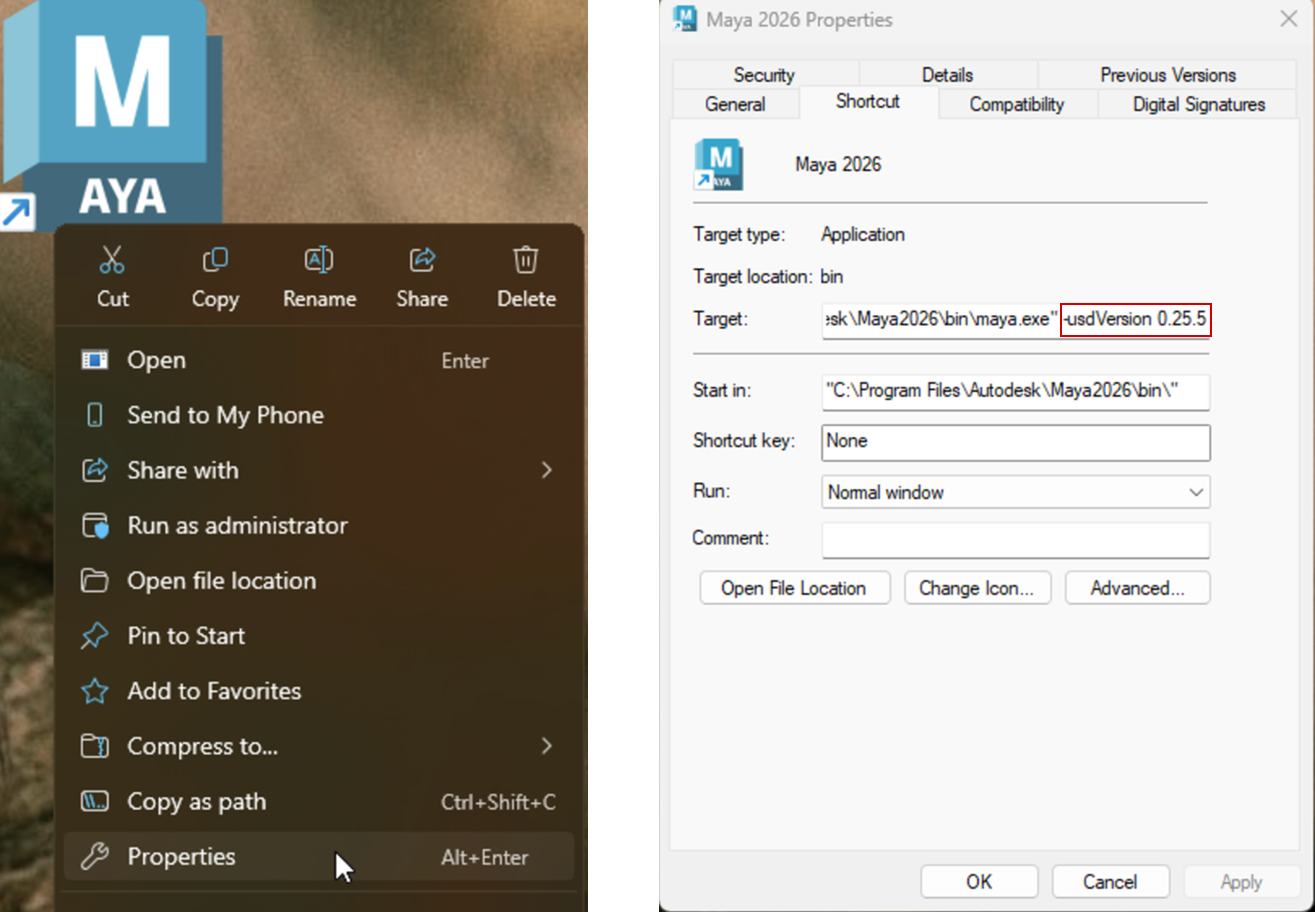

Installing multiple versions
USD for Maya 0.33 or later includes both USD 24.11 and USD 25.05 builds for Maya 2026.2. By default, it uses USD 24.11. To switch to USD 25.05, follow one of the options below:
USD for Maya versions install side-by-side. The MayaUSD that is loaded into the particular Maya version is defined by the .mod file. Multiple versions can be loaded by specifying the path to their install directory in the .mod file which can be found in:
This .mod file can be edited in any text editor (such as VSCode or Notepad). Replace the path of the installed version with the current version and then you should save your file and restart Maya to enact changes.
