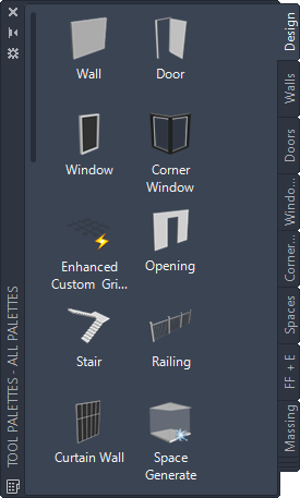

Tool palette containing a curtain wall tool
The following palettes contain one or more curtain wall tools:
Tool Palette | Curtain Wall Tools |
Design palette in the Design palette group | a tool for the Standard curtain wall style and default settings for other curtain wall properties |
Design Tool Catalog in Content Browser | a package of curtain wall and curtain wall unit tools. |
custom tool palettes created by your CAD manager | tools with curtain wall styles and properties that your CAD manager customized for your projects or office standards. |
