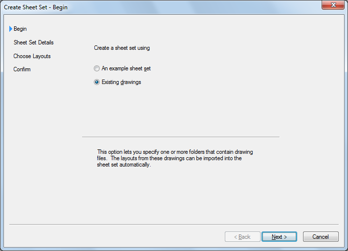

  4. Under Create a sheet set using, select Existing drawings, and then click Next.

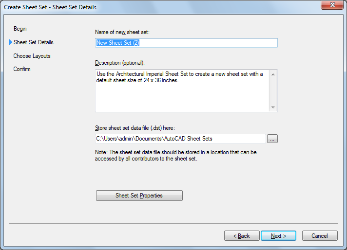

  5. In the Create Sheet Set - Sheet Set Details, enter a name for the new sheet set.
  6. Enter a description for the new sheet set.
  7. Select the folder location where the new sheet set template should be saved.
    Note: The location of a sheet set template (DST file) does not define the location of project sheet sets created from that template. A project sheet set is always stored in the root folder of the associated project.
  8. To define the properties of the new sheet set template, click Sheet Set Properties.
    The Sheet Set Properties dialog box is displayed.

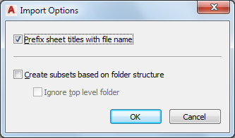

  24. To prefix sheet titles with the file name or create subsets of sheet sets based on the folder structure, click Import Options, select the options, and click OK.
