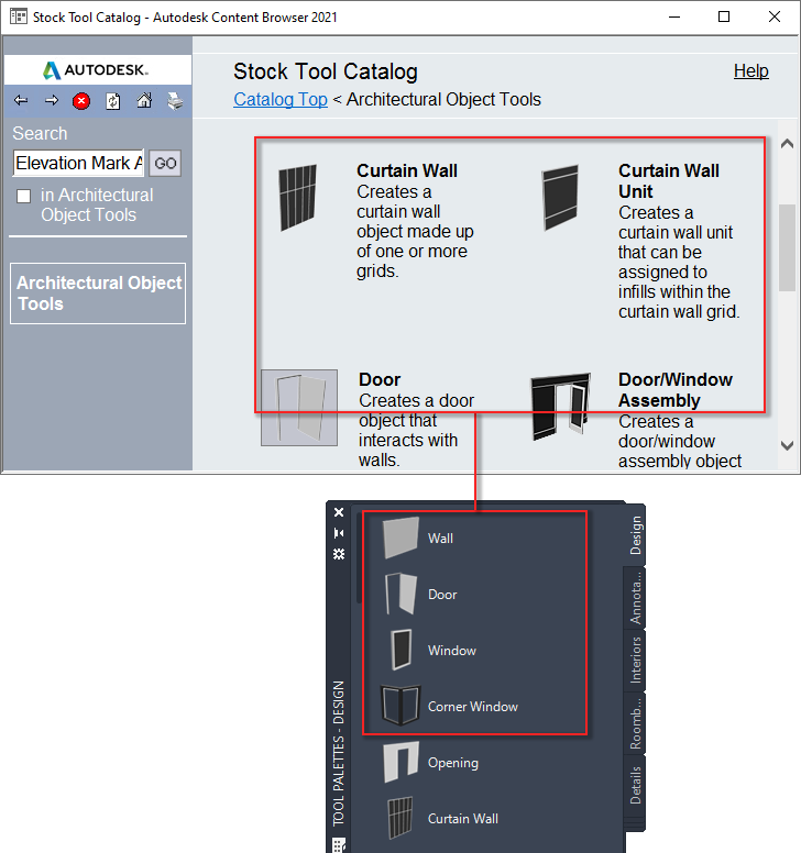

  1. Open the tool palette on which you want to place a tool from the Content Browser.
  2. Click Home tabBuild panelTools drop-downContent Browser, and navigate to the tool palette or category in the tool catalog that contains the tool you want to copy.
  3. Select Add to Tool Palette when you hover the cursor over the content icon.
    To copy multiple tool palettes, press and hold Ctrl while clicking each palette; then right-click and select Add to Tool Palette.

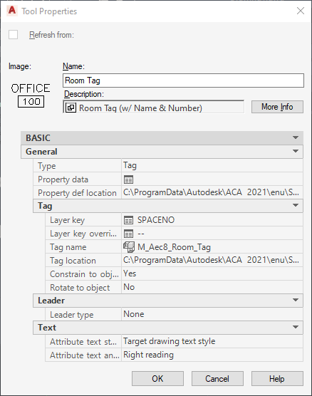

  4. To refresh the tool, select it, right-click, and click Refresh Tool.
    Alternatively, you can select the tool in the tool palette, right-click, and click Properties. Then select Refresh from on the Properties worksheet.
    Refreshing a tool from the Properties worksheet
    Note: When you select Refresh from, all tool properties on the worksheet are set to read-only. Properties for this tool must be changed in the Content Browser.
