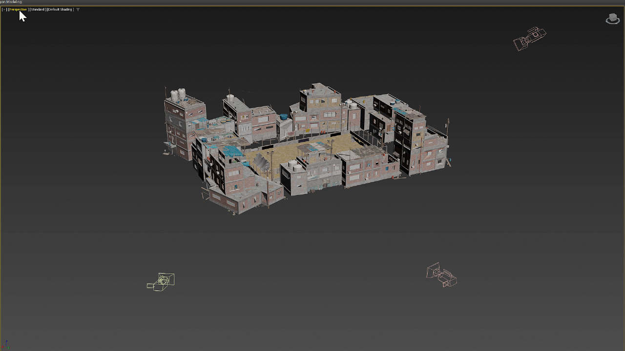

Ability to use USD cameras inside viewport
With this update, you can now use the cameras in a USD stage in the viewport. With this feature, you can view the camera compositions of the referenced file, including angles, field of view and animations.
