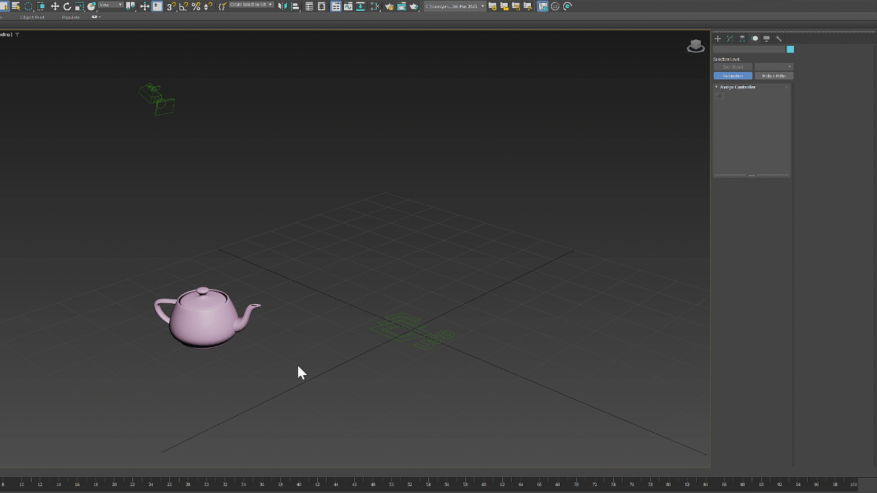

Select File > Reference > USD Stage.... In the Select USD File dialog, locate a USD file to reference.
Click into the viewport to become the point where the stage loads. In the Command Panel:

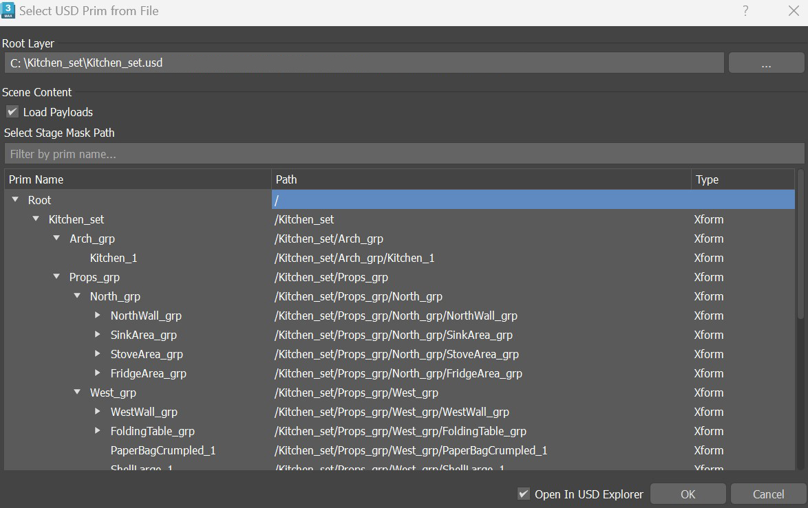

Under Object Type, select the USD Stage button. Select the ellipses ... next to the Root Layer label to open the Select USD File dialog and locate a USD file to reference.
Use the Select USD Prim from file dialog to build the scope of your USD reference.

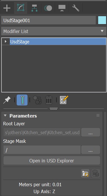

Use the Parameters Rollout in the Command Panel to configure or make changes to your USD stage reference at any point.

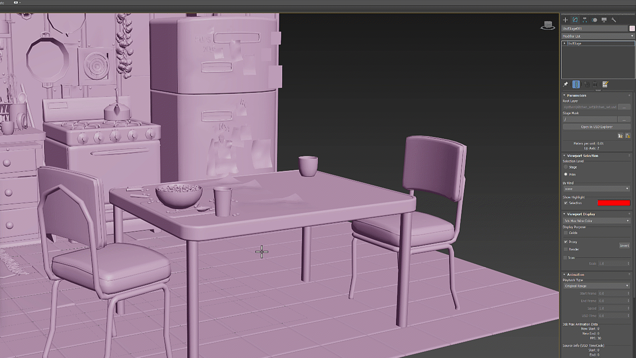

You can move, rotate and scale prims in the viewport while in the prim sub-object mode.
