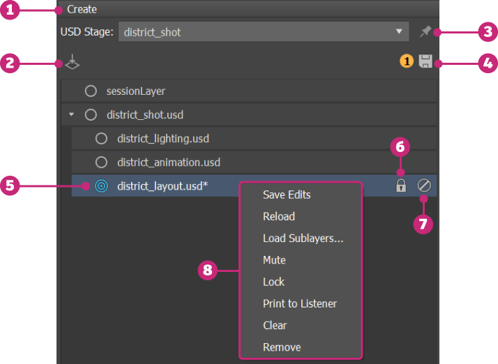

Interface overview
# Option Description
1 Create a stage Click to create a stage from an existing USD file. The stage object is selected by default when a stage is initially created.
2 Create an anonymous sublayer Click to add an anonymous sublayer to either the stage's root layer or the session layer.
3 Load an existing layer Click to load an existing layer as a sublayer to the selected layer or the root layer if no layer is selected.
4 Pin a stage Click to pin a stage. When pinned, the stage selection in the USD Layer Editor is maintained regardless of the selection made in the Scene Explorer. When unpinned, the stage selection in the USD Layer Editor automatically updates to reflect the stage currently selected in the Scene Explorer.
5 Save all edits Click to save a stage and bulk save any unsaved edits on your stage. The number of unsaved edits is displayed beside the save stage icon. This action opens a dialog box for you to confirm all the layers to be overwritten before saving the stage.
6 Set target layer Hover next to a layer name and click the grey target icon when it appears. Once a layer is set as the target layer, the highlighted target icon appears next to the layer name, and any scene editing operations are made on this layer. The root layer is set as the target layer by default when a USD stage is created. The target layer setting is maintained when you save and reload a scene.
7 Lock a Layer Click to lock a layer. When a layer is locked, you can't target or add sublayers to it. If a locked layer has sublayers, they can't have new parent layers added to them.
8 Mute a Layer Click to mute a layer. When a layer is muted, it's ignored by the stage and the contents of the muted layer disappear in the Viewport and Scene Explorer. Muted layers do not participate in value resolution or composition.
9 Context menu Access the context menu by right-clicking a layer.

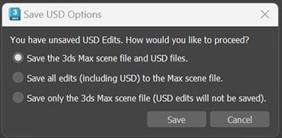

Save scene file with edits on layers
When you save a scene file with edits on USD layers, the Save USD Options dialog appears with three options:
Note:
You can save a USD stage with an anonymous root layer inside a 3ds Max scene file, without writing any USD files to disk.
