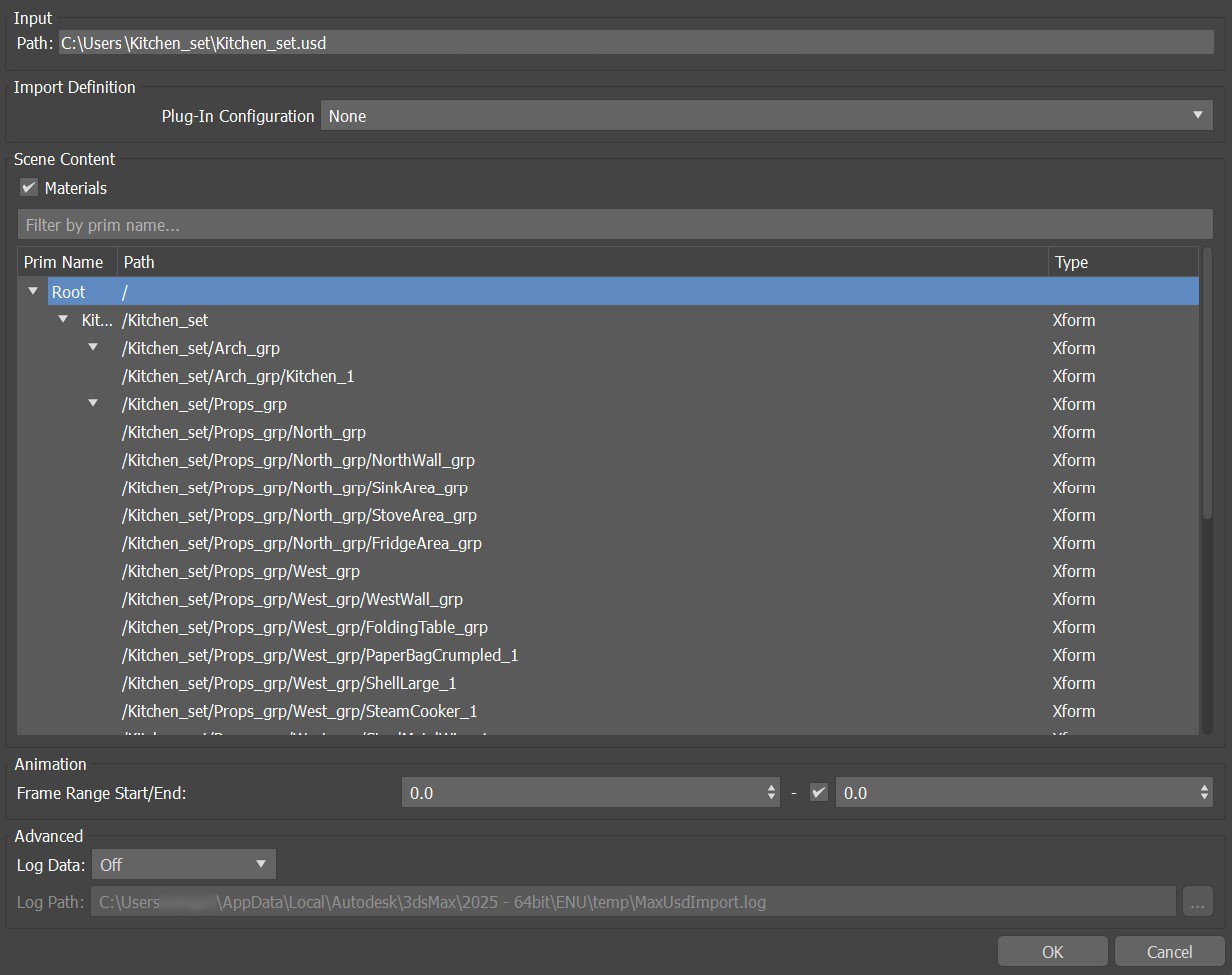

  1. To open the USD import options, select File > Import > Import... and select USD under the Files of type drop-down menu. Select a USD file for import, and click Open.
  2. In the USD Importer dialog, select what you want to import from the USD file.

  3. To accept the options and complete the import, select OK. Choose Cancel to cancel the import operation.
USD Importer
Input
Import definition
Scene content
A USD file consists of prims, the primary container object in USD. Prims can contain any scene element (such as meshes, lights, cameras). The import settings give you the following USD prim-specific options:
Animation
Advanced
Note:
The import dialog retains both the last chosen options and the collapsed or expanded state of rollups across 3ds Max sessions.
