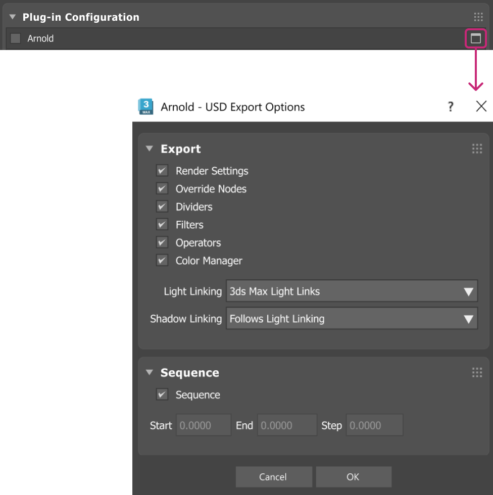

If registered and available, custom chasers can be toggled on from this section. If multiple configurations are registered, you can select multiple per export. You can also create a custom UI for managing additional settings of the plug-in configuration. You can access the custom UI window by clicking on the options box next to the plug-in name. See Advanced Scripting Workflows for more information.

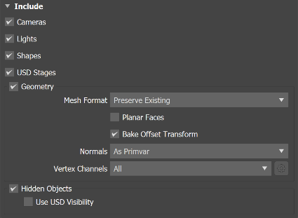

Cameras: When on, cameras are exported. Standard (physical, free and target cameras), 2 types of Vray cameras, and 4 types of Arnold cameras can export directly to USD format.
Note: If attribute values are specified to '0' for the USD file, those attributes will be overwritten as the following: Fstop 8, Shutter 0.5/F, Exposure of EV 6. Cameras with an undefined focus distance attribute get their focus set to 160 F (similar to a Free Camera setting).
Lights: When on, lights are exported. All mappable properties of photometric lights export into USD (including Light intensity, Colors, Direction and Type). There is limited ambient and diffuse multiplier effect support. Photometric SunPositioner exports to USD including sun orientation, mapping color and intensity.
Note: Light instances are not supported with RenderMan render delegate in USDView.
Shapes: When on, shapes are exported. This includes basic curve data extracted to the USD file.
Note: Shapes that do not display in viewport export as UsdGeomBasisCurves
and shapes that display in the viewport export as UsdGeomMeshes
USD Stages: When on, USD stage objects or prims that are found in the 3ds Max scene are exported as USD references to whatever the root layer of that stage object is.
Important: The exported USD references do not reflect the current stage mask if one has been applied to the stage, nor does it contain the animation options for the stage.
USD Stage warnings:
a. The referenced layer has no default prim. In this case, the Exporter uses the first prim found as a reference target.
b. The referenced layer has multiple root prims. In this case, the result might not match expectations, as only a single prim can be targeted in the reference.
c. The layer has in-memory changes (is dirty). In this case, those edits aren't saved and the result may not reflect the current viewport representation.
Geometry: When on, mesh geometry will be exported.
Note: Bone objects (including CAT and Biped) export with the purpose set to guide
in USD. This means they do not render, and by default are not shown in USDView. To see them in USDView and verify your export, you need to turn on the display of the Purpose Guide.

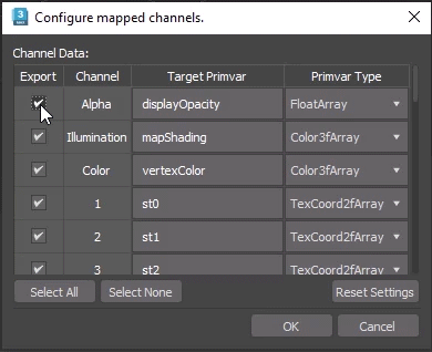

Export: Select to include in export.
Channel: Specifies the map channel ID.
Target Primvar: Type in the specific primvar to target. Primvar name can only contain alphanumeric characters, underscores, and the field cannot be empty.
st0
, st1
, st2
. in the USD Exporter to align more closely with the names used in other applications (such as Maya). This enables ease of material library reuse across applications. If you are an advanced user, you can customize the naming translations using scripting. Primvar Type: Specifies the type of primvar for the channel.
Hidden Objects: When on, hidden objects are included in your USD export.

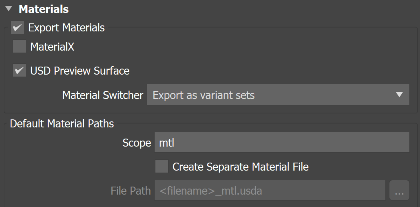

Export Materials: If selected, material targets defined in this group and through plug-in configurations are used for USD export. A basic material is always exported, even when the material is not understood during material translation (name and diffuse color is written out to the export). This materials list can also grow and provide more options depending on available plug-in additions, custom shader and chaser networks. See Advanced Workflows below to learn more.
MaterialX: Exports USD assets referencing MaterialX material targets.
USD Preview Surface: When on, all supported materials are converted to UsdPreviewSurface
shaders on export. Supported 3ds Max materials are USD Preview Surface and Physical Material.
Support: The USD Exporter creates proper UDIMs in Max when exporting USD Preview Surface Materials with UDIMs. OSL maps are required: Uber Bitmap and Bitmap Lookup UDIM maps are supported.
Material Switcher: A Material Switcher USD writer is available for 3ds Max 2024 and above from the Slate Material Editor > Material Switcher. Once you have materials set to your USD prims, in the exporter dialog, choose from export as variants set (default) which exports all material inputs into material variants and export active material only which only exports the active material and binds it to the prim. Material Switcher supports the use of multi/sub-object materials when exporting a USD file (for creating material variants).
Create a separate USD file that is layered into your main export file with these settings.
Scope: Choose the prim path or build out the scope of where your materials go. By default, this material prim is written as mtl
and will be defined as a def prim.
Create Separate Material File: Enable this toggle to create a separate file for your materials layered inside your export.
Warning: Use this toggle with caution as it will overwrite a USD file using the same path in another export. If you are an advanced user, script to set a relative path for this setting so that it will not require changes if you are constantly changing the exported file. A relative path example would be MyFolder/MyFileOneFolderDown.usda
or ../MyFileOneFolderUp.usda
. However, note that even if using a relative path, the file can overwrite previously exported material files if the main file is in the same folder path as previous export.
File Path: Specify where to save your separate material file. Select the ellipses to navigate to a directory. Note: Unicode characters are not supported in this input.

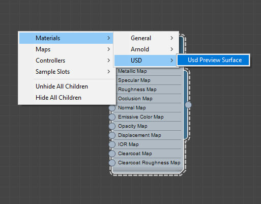

UsdPreviewSurface
materials, per material. However, this feature is experimental.UsdPreviewSurface
by selecting Materials > USD > USD Preview Surface.

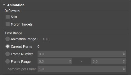

Deformers
Skin: When on, the export encodes skin and skeletons as USDSkel. Skinned meshes export as USDSkel instead of animated vertex caches.
Note: USD cannot resolve the modifier stack when modifiers that change mesh topology are applied. Any modifier like morpher or turbo smooth is expected to be below the Skin modifier when they both are present in a 3ds Max node. A warning presents when this hierarchy is incorrect.
Morph Targets: When on, exports morph targets as USD blend shapes. Animations using morph targets thus get exported as USD blend shapes and the animation will appear when viewing the exported file in USDView. Progressive morphers will be exported as in-between USD blend shapes.
Warning: Morph targets export with USD blend shapes, but skinning information may not properly display in USDView. See Limitations for more information and a workaround.
Time Range
Select the time at which animation data is exported from your scene. You can select a frame range to export to USD and the animations will be cached into USD. Choose from the following options:

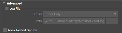

Log File: When on, a log file is output with your render. By default, log data is not stored.
Allow Nested Gprims: When on, the export allows for nested geometric prims (GPrims). This can maintain existing hierarchy and help performance by reducing prim counts.
