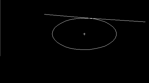

Assume the curve being measured is the ellipse in the following drawing:
Sample curve (ellipse) for vlax-curve-getArea
The ellipseObj variable points to the ellipse VLA-object.
The following command obtains the area of the curve:
(vlax-curve-getArea ellipseObj) 4.712393
