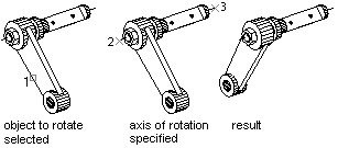

With the TransformBy method of an object and the Rotation method of a Matrix, you can rotate objects in 2D about a specified point. The direction of rotation for 2D objects is around the Z axis. For 3D objects, the axis of rotation is not limited to the Z axis. When using the Rotation method instead of using the Z axis for the rotation axis, you specify a specific 3D vector.
Create a 3D box and rotate it about an axis
This example creates a 3D box. It then defines the axis for rotation and finally rotates the box 30 degrees about the axis.
