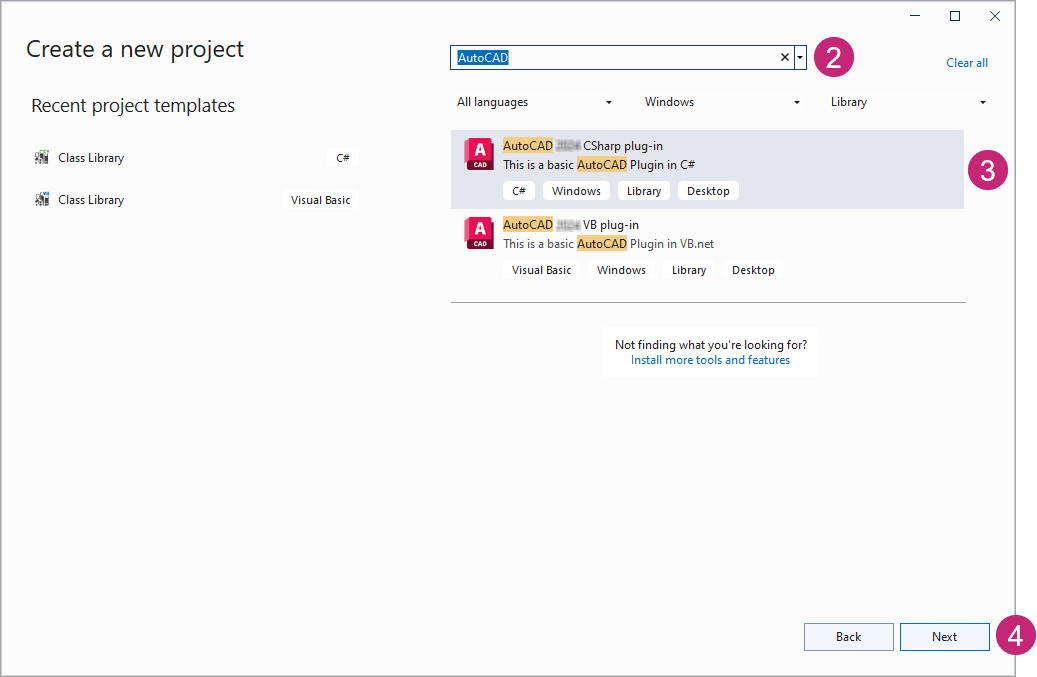

    To create a new project using an AutoCAD Managed template
    Before using one of the AutoCAD Managed templates, you must first download and install the latest release of the ObjectARX SDK.
  1. In Microsoft Visual Studio, click File menu New Project (or click File menu New Project).
  2. In the Create a New Project dialog box, click in the Search box and enter AutoCAD.
  3. From the Templates list, select AutoCAD <release> C Sharp Plug-in (or AutoCAD <release> VB Plug-in).
  4. Click Next.

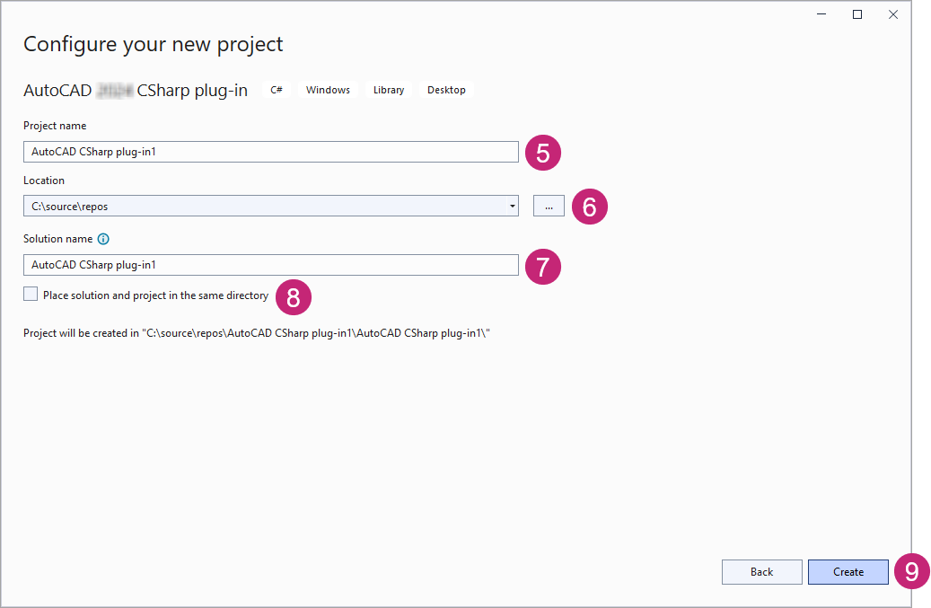

  5. In the Configure Your New Project dialog box, click in the Project Name box and enter a name for the new project.
  6. In the Location box, enter a location or click Browse to select a folder for the new project.
  7. In the Solution Name box, enter a name for the new solution that the project will be added to.
  8. Optionally, clear the Place Solution and Project in the Same Directory check box to create a sub-folder under the solution for the project.
  9. Click Create.

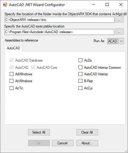

  10. In the AutoCAD .NET Wizard Configurator dialog box, specify the libraries to reference to the project.
  11. Click OK.
