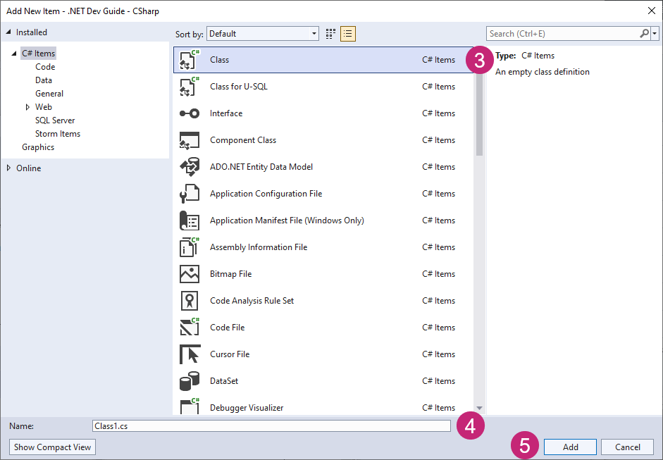

To add a new item to your project
- In Microsoft Visual Studio, Solution Explorer, right-click the project to which you want to add a new item and click Add
New Item.
- In the Add New Item dialog box, click Show All Templates.
- In the Add New Item -
<project> dialog box, select the template that represents the item you want to add.
- Code File - Represents a code module
- Window (WPF) - Represents a form (or dialog box)
- Class - Represents a class module
- In the Name text box, select the default name and enter a new name for the item.
- Click Add.
