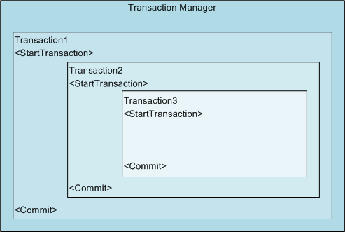

Transactions can be nested one inside another. You might have an outer transaction to undo all the changes made by your routine and inner transactions to undo just portions of the changes made. When you work with nested transactions, you start with a top transaction which is also the outer most transaction.
As you start new transactions, they are added into the previous transaction. Nested transactions must be committed or aborted in the opposite order in which they are created. So if you have three transactions, you must close the third or innermost one before the second and finally the first. If you abort the first transaction, the changes made by all three transactions are undone.
The following illustration shows how transactions appear when nested.
