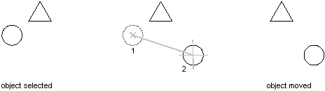

You can move all drawing objects and attribute reference objects along a specified vector.
To move an object, use the Displacement function of a transformation matrix. This function requires a Vector3d object as input. If you do not know the vector that you need, you can create a Point3d object and then use the GetVectorTo method to return the vector between two points. The displacement vector indicates how far the given object is to be moved and in what direction.
Move a circle along a vector
