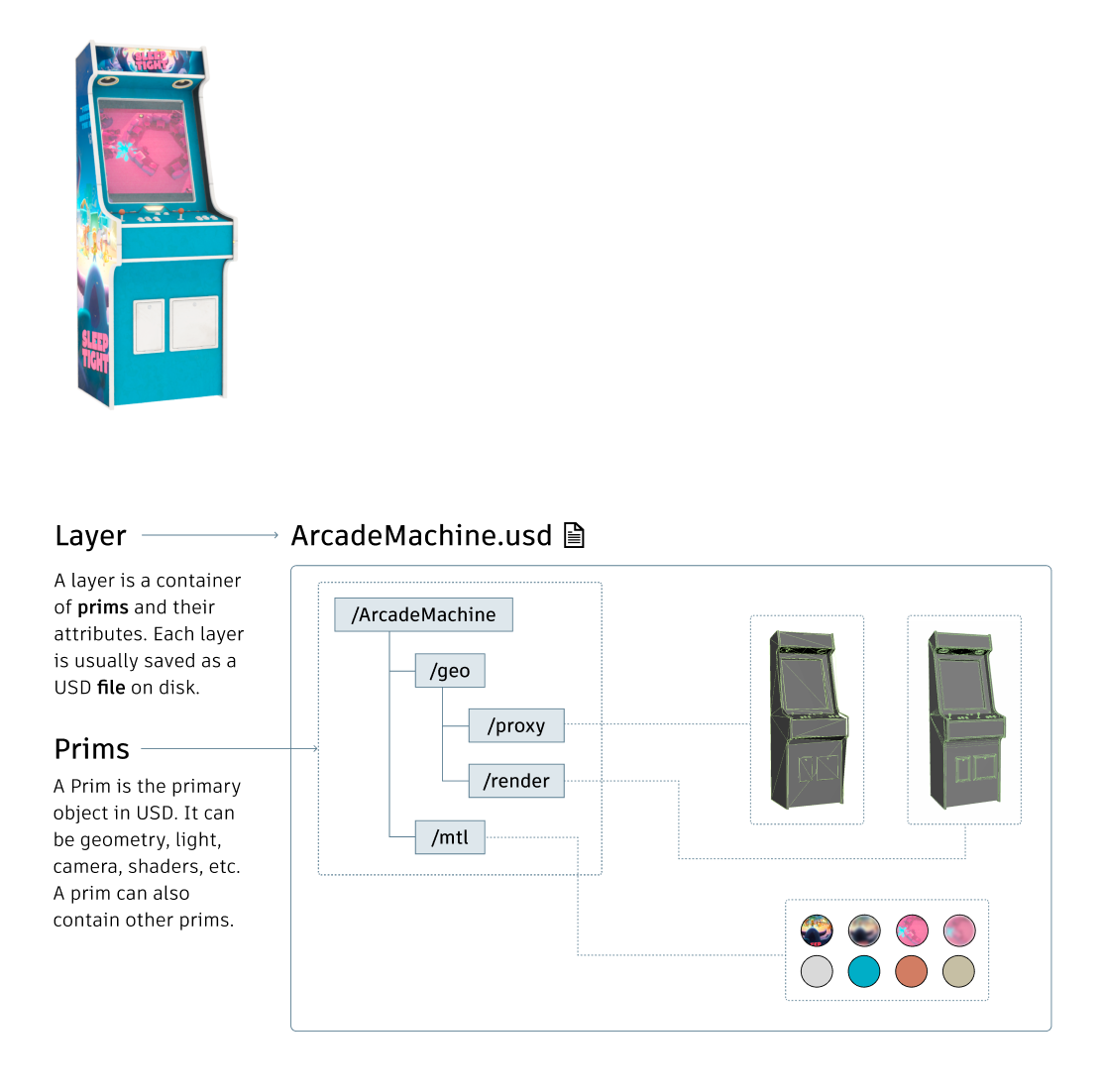

USD component
The following diagram shows an example of the structure of a USD component. The prim ArcadeMachine has two children, geo and mtl, which store the geometry and materials, respectively. The prim geo has two children, proxy and render, which store the low-res and high-res meshes for proxy and render purposes.
img for USD terminology & composition 1

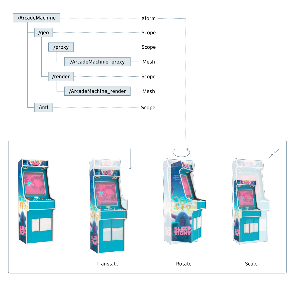

Prim types
Prims come in a variety of types, such as Xform, scope, mesh, shader, light and camera. Among them, XForm contains transform data that can be used to translate, rotate and scale other prims; and scope serves as a container for grouping other prims without applying any transformation.

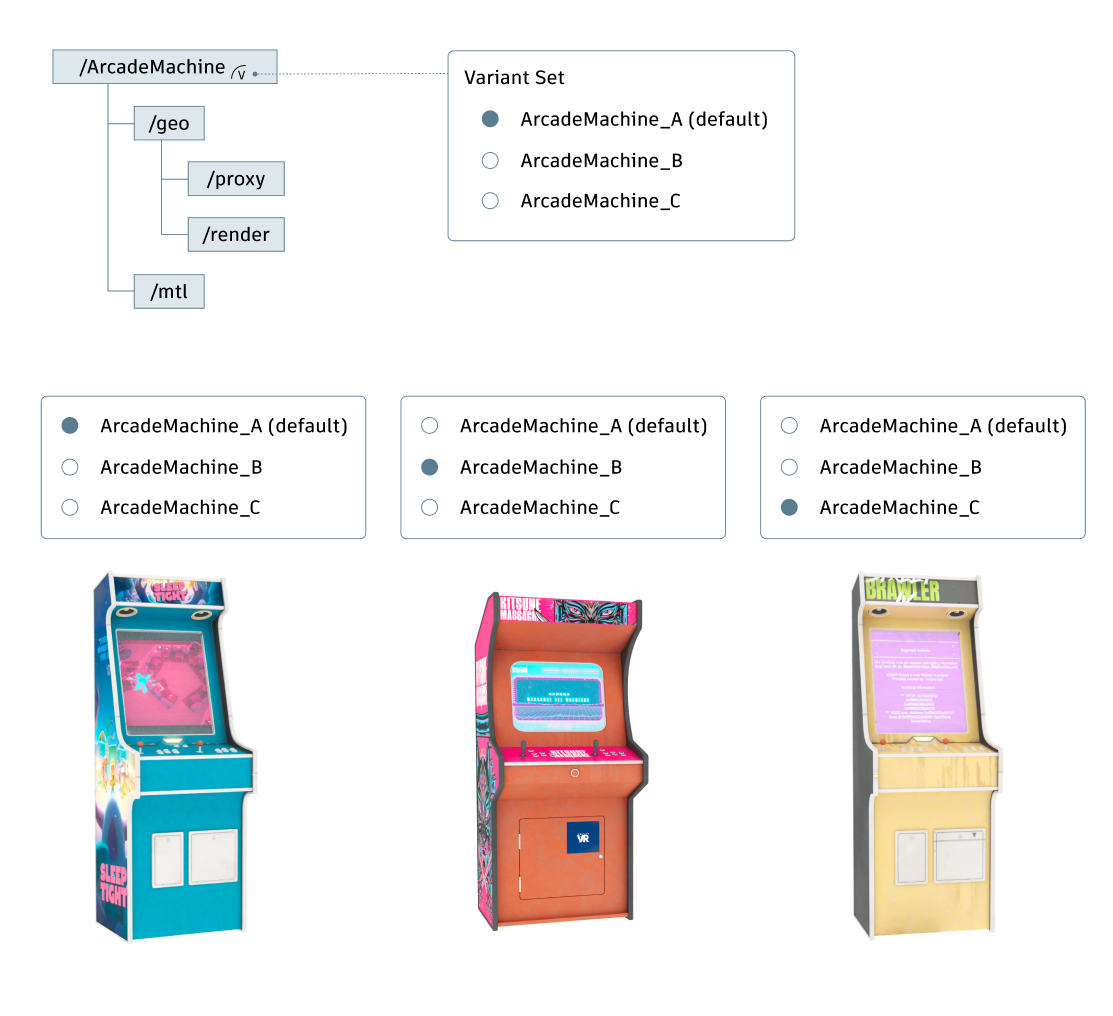

Variants
A prim can store multiple variants, allowing easy switching between them. Variants can be organized into variant sets.
img for USD terminology & composition 3

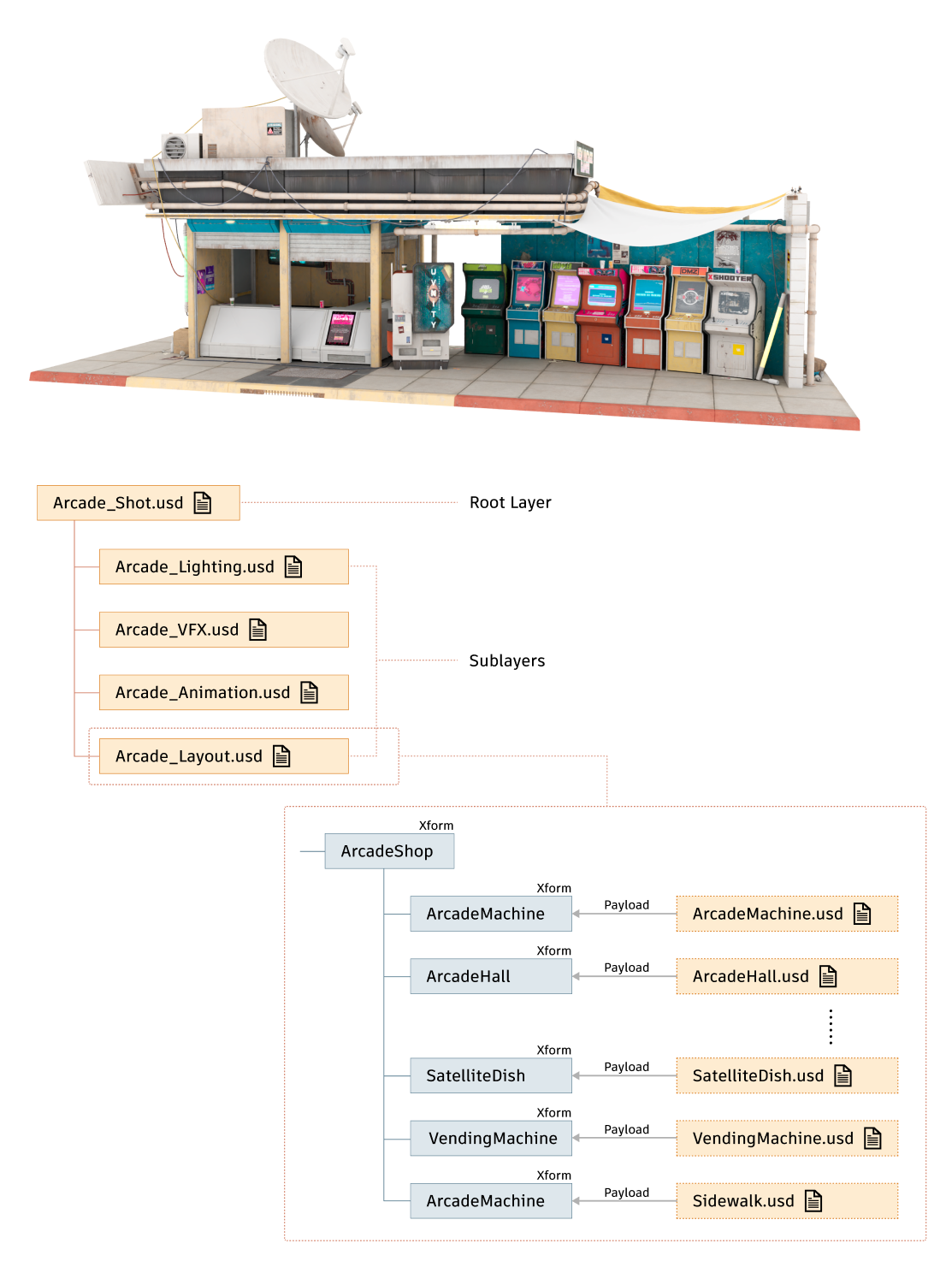

USD shot
A shot is usually composed of a root layer and several sublayers, each dedicated to a specific division of the pipeline, such as layout, animation, VFX, or lighting. Each sublayer usually contains Xform prims that reference USD components as payloads. Instancing is often used when laying out a scene with multiple copies of an object. In the example below, only one arcade machine is loaded, while the others are instances of the same prim.
