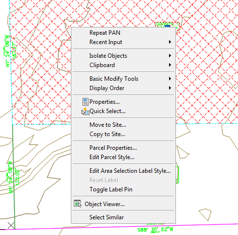

Plot Area Selection Label
The plot area selection label is an embedded object that cannot be deleted, as it is used to select a plot. The plot area selection label is distinct from other plot area labels. The area selection label and other plot labels are all supported by the AutoCAD Properties palette. To edit the plot area selection label, right-click and select Edit Area Selection Label Style as shown in figure 12.
Figure 12: Plot area selection label context menu
