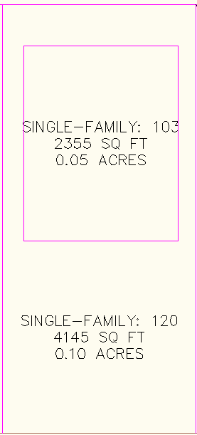

If you create a plot from a closed area, such as a polygon that is fully enclosed in a plot, the smaller area will be subtracted from the total area of the larger plot. You end up with two plots, with one being an island plot inside of the other as shown in figure 1.
Figure 1: Enclosed plot subtracts area from larger plot
