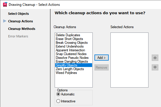

Map 3D Cleanup
A powerful utility developed for AutoCAD Map 3D is also included with Autodesk Civil 3D. It enables you to delete duplicate objects, weed polylines, and do many other cleanup actions. You can set several parameters to control each action. Access the cleanup tools in one of two ways:
The Drawing Cleanup dialog box opens, as shown in figure 17.
Figure 17: Map 3D drawing cleanup actions
Note:
While you can run several actions together, it is recommended that you do them one at a time for better monitoring and control.
