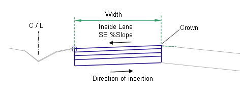

L1
Top, Pave
Finish surface
L2
Pave1
L3
Pave2
L4
Base
L5
SubBase
Datum
S1
Pave1
S2
Pave2
S3
Base
S4
SubBase
Coding Diagram
