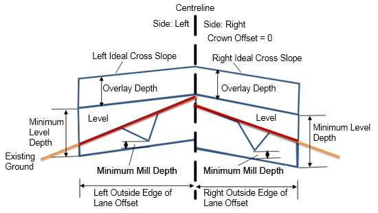

OverlayMillLevelCrown
This subassembly adds an overlay layer to an existing crowned carriageway, with either a levelling and milling layer added as required.

Behaviour
This overlay layer assumes that flapping is applied within slope tolerance. Level at the crown will meet both sides of the carriageway.

P1, Crown Crown point for top of overlay
P2, P3 EOV Edges of overlay for finished gradient
P4 Crown_Overlay Crown point for bottom of overlay
P5, P6 EOV_Overlay Edges of bottom of overlay for left and right side of the road
P7 Crown_Milling Crown point for top of mill
P8, P9 EOV_Milling Edges of mill for right and left side of road
L1, L2 Top, Pave Top of overlay for left and right side of the road
L3, L4, L5, L6 Overlay Overlay links for the left and right side of the road
L7, L8 Level, Mill, Datum Links for the milling layer
L9, L10 Level Level links for the left and right side of the road
L11, L12 Mill Mill links for the left and right side of the road
S1 Overlay Area between the top and bottom of the overlay
S2 Level Area between the top and bottom of the elevation
S3 Mill Area between the top and bottom of the mill
Coding Diagram
