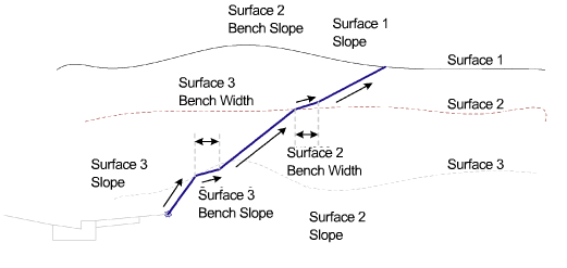

This subassembly lets you specify three surface layers and cut slopes for each material type.
When transitioning between types, a bench can also be inserted.
The attachment point is at the inside edge of the initial cut or fill slope. This component can be attached to either the left or right side.

| Parameter | Description | Type | Default |
| Side | Specifies which side to place the subassembly. | Left/Right | Right |
| Surface 1 Cut Slope | Slope to use for Surface 1 Material | Numeric, positive | 4 (:1) |
| Surface 2 Bench Width | Specifies bench width between surface 1 and 2 (zero to omit) | Numeric, positive | 0 |
| Surface 2 Bench Slope | Specifies slope of optional bench | Numeric, positive | 4 (:1) |
| Surface 2 Cut Slope | Slope to use for Surface 2 Material | Numeric, positive | 2 (:1) |
| Surface 3 Bench Width | Specifies bench width between surface 1 and 2 (zero to omit) | Numeric, positive | 0 |
| Surface 3 Bench Slope | Specifies slope of optional bench | Numeric, positive | 4 (:1) |
| Surface 3 Cut Slope | Slope to use for Surface 3 Material | Numeric, positive | 1 (:1) |
| Fill Slope | The slope of the daylight link in fill conditions | Numeric, positive | 4 (:1) |
| Place Lined Material | Specifies to place optional material lining along daylight links. You can choose All Links, Daylight Links, Fill Links Only, and None. | String | None |
| Slope Limit 1 | Specifies the slope limit until which the associated material lining is placed | Slope | 1 : 1 |
| Material 1 Thickness | Specifies the thickness of lined material. This thickness is measured perpendicular to the link. | Numeric, positive | 12 inches |
| Material 1 Name | Specifies the name of the material applies for lining along grading links | String | Rip Rap |
| Slope Limit 2 | Specifies the slope limit until which the associated material lining is placed | Slope | 2 : 1 |
| Material 2 Thickness | Specifies the thickness of lined material. This thickness is measured perpendicular to the link. | Numeric, positive | 6 inches |
| Material 2 Name | Specifies the name of the material applies for lining along grading links | String | Rip Rap |
| Slope Limit 3 | Specifies the slope limit until which the associated material lining is placed | Slope | 4 : 1 |
| Material 3 Thickness | Specifies the thickness of lined material. This thickness is measured perpendicular to the link. | Numeric, positive | 4 inches |
| Material 3 Name | Specifies the name of the material applies for lining along grading links | String | Seeded Grass |

In a fill situation, a daylight link is inserted with a slope based on the fill slope input parameter to surface 1. In cut, the subassembly first checks to determine if it is below surface 3 by applying the surface 3 slope, and checking for intersection. This process repeats for each additional surface. Optionally, between the surfaces optional transitions can be added at the surface changes. The bench width and slope for the surface that was just intersected will be used.
In Civil 3D 2010 and previous versions, the Material Thickness parameter was measured vertically. In Civil 3D 2011 and later, this parameter is measured perpendicular to the link. Therefore, if you open a drawing containing these subassemblies that was created in Civil 3D 2010 or prior in Civil 3D 2011 or later, and then rebuild the corridor(s), this parameter will be changed to reflect the new behavior. Any volume reports that use this subassembly will be updated to reflect the new behavior.
This subassembly displays in layout mode using the input parameters for Surface 1 Slope and Fill Slope.
