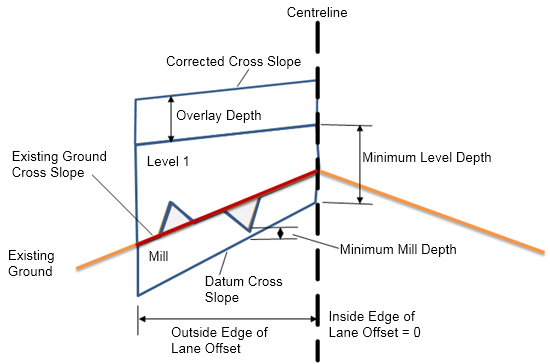

  • Areas must be provided for all layers.
  • The Levelling area is equal to the areas of Level 1 + Mill layers combined.
  • The Milling Area layer is represented in the diagram below as Mill.
  • Minimum Level Depth is equal to the area from the bottom of the milling layer to the bottom of the overlay layer.

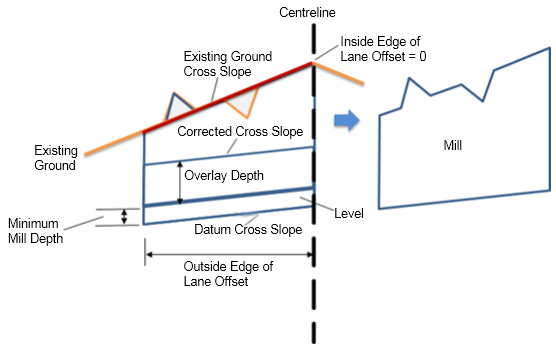

Special Case
The following is an example when Use Profile is selected in Profile Options and the overlay is located below the existing ground.
Behaviours:
  • The Minimum Mill Depth is measured down from the bottom of Overlay to the Datum layer.
  • The area of Minimum Mill Depth will be filled as Level area.
  • Total Mill area is from the Datum layer to the Existing Ground layer.
Point, Link and Shape Codes
Point, Link or Shape Code Description
P1, P2 EOV Overlay edges on finished gradient (edges of top of overlay)
P3, P4 EOV_Overlay Overlay edges beneath levelling layer (edges of bottom of overlay)
P7, P8 EOV_Milling Overlay edges beneath milling layer (edges of bottom of mill)
L1 Top, Pave Top of overlay
L2, L3, L4 Overlay Overlay links
L5, L6 Level For the levelling case
L7, L8 Mill For the milling case
L9 Level, Mill, Datum Links for the milling layer
S1 Overlay Area between the top and bottom of overlay. This area overlaps the levelling area as shown in the coding diagram below
S2 Level Area above existing surface and below the bottom of overlay (levelling case)
S3 Mill Area between bottom of existing surface and bottom of mill (milling case)
Note: Multiple Links will occur when the Existing Ground surface is not smooth. This is shown in the image below by L10.
