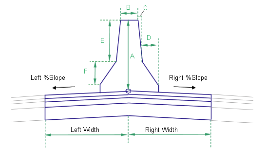

Dimension A (mm or inches) |
Height of the barrier at the center of central reserve |
Numeric, positive |
810 mm 32 in |
Dimension B (mm or inches) |
As shown in diagram |
Numeric, positive |
232 9 in |
Dimension C (mm or inches) |
Numeric, positive |
59 mm 2 in |
Dimension D (mm or inches) |
Numeric, positive |
125 mm 5 in |
Dimension E (mm or inches) |
Numeric, positive |
557 mm 22 in |
Dimension F (mm or inches) |
Numeric, positive |
178 mm 7 in |

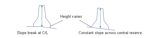

The pavement structure links are inserted outward left and right of the attachment point for the given widths and slopes. If the Include Barrier value is True, a New Jersey barrier is inserted symmetrically about the central reserve centerline. If alignments are given as target parameters for the Left and Right Widths, the widths are adjusted to tie to the alignment offsets at each chainage along the corridor.
If the central reserve is in superelevation with a single constant slope across the entire central reserve, the top of the barrier is slanted to match the central reserve slope. Otherwise the top of the barrier remains horizontal. In all cases, the barrier height (Dimension A) is held constant at the centerline of the barrier.
