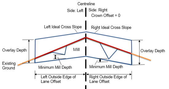

OverlayMillCrown
This subassembly adds an overlay layer on top of an existing crowned carriageway with a milling layer added as required.
The attachment point is the crown point of the overlay layer with finished ground crossfall.

P1 Crown Crown point for top of overlay
P2, P3 EOV Overlay edges on finished gradient for the left and right side of the road
P4 Crown_Overlay Crown point for bottom of mill
P5, P6 EOV_Overlay Edges of bottom of mill for the left and right side of the road
P7, P8 EOV_Milling Edges of top of mill for the left and right side of the road
P9 Crown_offset Offset of the crown point from attachment point.
L1, L2 Top, Pave Top of overlay for left and right side of road
L3, L4, L5, L6 Overlay Links for the overlay layer.
L7, L8 Mill Mill links (height) for left and right side of road
S1 Overlay Area between the top and bottom of overlay
S2 Mill Area between the top and bottom of mill
Coding Diagram
