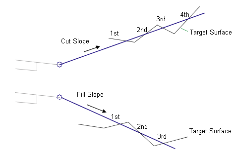

This subassembly is used when a cut or fill daylight slope may have more than one intersection with the target surface.
An input parameter controls which intercept is used.
You can also specify optional lined materials for daylight and other links (All Links, Daylight Links, Fill Links Only, and None).
The attachment point is at the hinge point of the daylight link. This component can be attached to either the left or right side.

This subassembly attempts to find all possible daylight points for the cut slope condition. If one or more daylight points are found, they are ordered and numbered by increasing offset from the hinge point. The daylight link is terminated at the point that matches the Intercept Number value. If the intercept number is higher than the number of intercepts found, the last intercept is used.
If no daylight points are found for the cut condition, the process is repeated for the fill condition.
