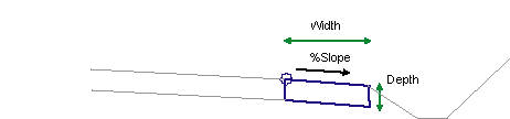

BasicShoulder
This subassembly creates a simple paved shoulder with finish surface and subbase.
This subassembly is one of a group of Getting Started subassemblies used for simple carriageway modeling, and for tutorial and training purposes.
The attachment point is at the inside edge of the shoulder on the finish surface.
Input Parameters
Note: All dimensions are in meters or feet unless otherwise noted. All slopes are in run-over-rise form (for example, 4 : 1) unless indicated as a percent slope with a “%” sign.
Parameter
Description
Type
Default
Side
Specifies which side to place the subassembly.
Left / Right
Right
Width
Width of shoulder
Numeric, positive
0.9 m
3 ft
Depth
Depth from finish surface to subbase
Numeric, positive
0.2 m
0.67 ft
%Slope
% Slope of the shoulder
Numeric
-4%

Behavior
The shoulder links are inserted outwards from the attachment point at the given width, slope, and depth.
