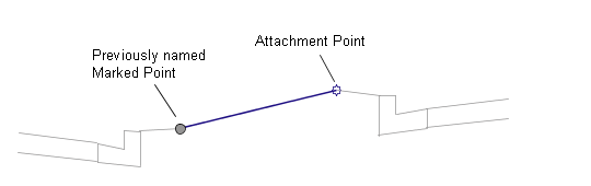

This subassembly is a general purpose utility to connect a link from the attachment point to a previously named marked point.
It can be used in a variety of situations, including connecting between adjacent carriageways where the relative offsets and levels vary, or across a nose area between converging carriageways. Use the MarkPoint subassembly if the connecting point has not already been named.

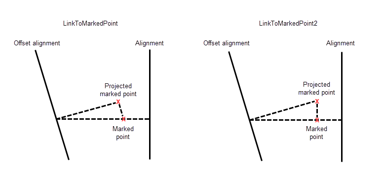

The primary difference between the LinkToMarkedPoint2 subassembly and the LinkToMarkedPoint subassembly is in its application, when the marked point is on an offset assembly baseline comparing to the link. The following illustration shows the difference between the two subassemblies.

The attachment point is at the beginning of the link. The link may go in any direction. The direction is determined by the location of the marked point relative to the attachment point. Be sure to name the marked point and set the marked point name in this subassembly.
