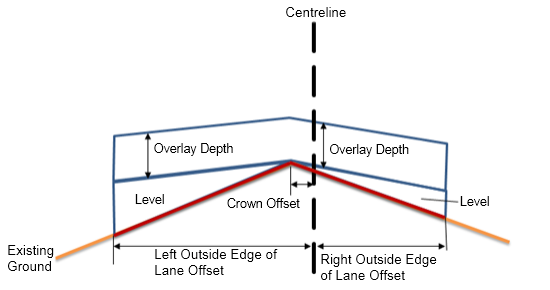

Crown Offset Positive or negative offset at the crown point Numeric 0.000m (0.00 ft)

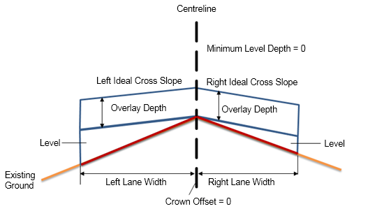

Overlay Depth Depth of the overlay layer Numeric, positive 0.300m (0.300 ft)

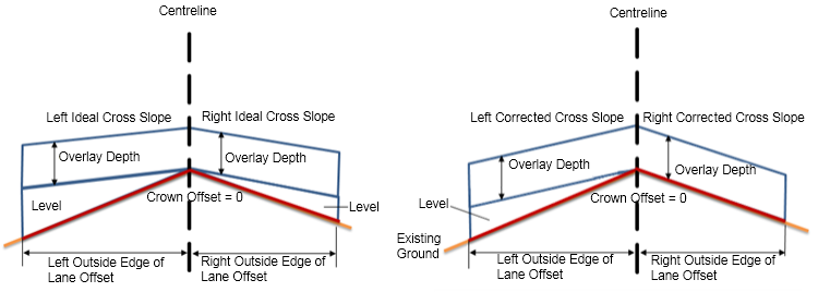

Right and Left Overlay Slope Options Specifies right and left overlay slope options
Tip: Flapping is a term used to describe how the corrected cross slope for an overlay in a rehab subassembly is calculated. Flapping outcomes are different, relative to the slope tolerance and the slope difference between existing ground cross slope and ideal cross slope. If the slope difference is less than the slope tolerance for the subassembly, then the use case is considered "within tolerance". If the slope difference is greater than the slope tolerance for the subassembly, then the use case is considered "outside of tolerance".
Note: Slope tolerance is an absolute value. Therefore, for either a slope difference of 0.4% or -0.4%, both have an absolute value of 0.4%. If the slope tolerance is 0.5%, the 0.4% absolute slope difference would be considered within tolerance.
  • User Defined with Flapping
    Flapping specifies how the corrected cross slope will be calculated, relative to the slope tolerance for the subassembly.
    • Flapping Within Tolerance:
      The corrected cross slope will be the existing ground cross slope.
    • Flapping Outside of Tolerance:
      The corrected cross slope will vary and will be the existing ground cross slope plus or minus the slope tolerance value.
      Note: Whether the slope tolerance is added or subtracted depends on which one will bring the values of the existing ground cross slope and the ideal cross slope closer together.
  • User Defined Without Flapping
    Flapping specifies how the corrected cross slope will be calculated, relative to slope tolerance for the subassembly.
      The corrected cross slope will be set equal to the ideal cross slope.
      The corrected cross slope will be the ideal cross slope plus or minus the slope tolerance value.
  • Outside/Inside Lane Superelevation
    Outside or Inside Lane Superelevation will replace Ideal Crossfall. The corrected cross slope values for the overlay layer will be defined by the superelevation table for the section instead of the ideal cross slope.
    Note: If Outside/Inside Lane Superelevation is chosen but the alignment for the rehab corridor doesn't have a superelevation table defined, Ideal Crossfall will be used instead.
    • Within Tolerance:
      • If a superelevation table is defined for the alignment: The corrected cross slope will be the lane superelevation value obtained from the superelevation table.
      • If a superelevation table is not specified for the alignment: The corrected cross slope will be the specified ideal slope.
        Note: This behaviour is the same as for the User Defined without Flapping option.
    • Outside of Tolerance:
      • If a superelevation table is defined for the alignment: The corrected cross slope will be the lane superelevation value obtained from the superelevation table plus or minus the slope tolerance value.
      • If a superelevation table is not specified for the alignment: The corrected cross slope will be the specified ideal slope plus or minus the slope tolerance value.
  • Match Slope
    The corrected cross slope is always set equal to Existing Ground Slope.
  • Use Ideal Crossfall
    The corrected cross slope is always set equal to Ideal Cross slope.

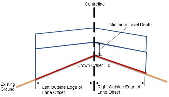

Left Minimum Level Depth The minimum level depth between the existing surface and the bottom of the left overlay layer Numeric, positive 0.300m (0.300 ft)

Left Lane Width The left lane width, determined by the offset of the outside edge of the left lane from the inside edge of left lane Numeric, negative -12.000m (-12.000 ft)
Right Lane Width The right lane width, determined by the offset of the outside edge of the right lane from the inside edge of right lane Numeric, positive 12.000m (12.000 ft)

Minimum Level Depth
Note: The minimum level depth represents the minimum depth of the levelling layer, measured between the existing ground high point and the bottom of the overlay layer.
Crown Offset
Note: The distance that the crown point for the subassembly is offset from the road centreline.

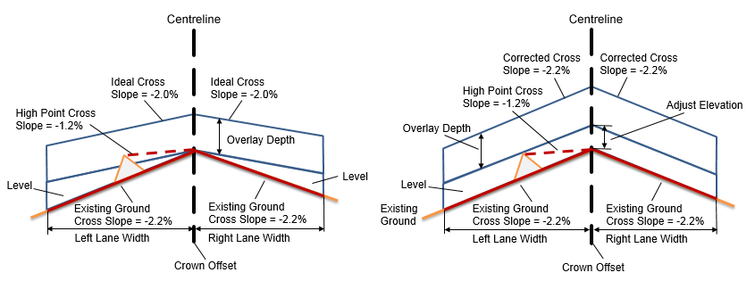

Behaviour
This subassembly assumes that no milling layer is added to the subassembly.
Inputs:
Inputs Value
Ideal Crossfall, Left -2.0%
Ideal Crossfall, Right -2.0%
Crown Offset 0.000' (0.00m)
Left Lane Width 12'' (3.6m)
Right Lane Width 12'' (3.6m)
Minimum Level Depth 0.000' (0.00m)
Slope Tolerance 0.50%
Overlay Slope Options User Defined with Flapping
Use Profile Options Minimum Level Depth
Calculations:
Left Side Input Value
Existing Ground Crossfall -2.2%
Existing Ground Crossfall – Ideal Crossfall 0.2%
High Point Crossfall, measured from Crown Point to High Point -1.2%
High Point Crossfall – Ideal Crossfall 0.8%
Slope Tolerance The Slope Difference between the Existing Ground Cross slope minus Ideal Cross slope result is 0.2%, which is less than the Slope Tolerance of 0.50%
Corrected Crossfall
The Corrected Cross slope will be adjusted to -2.2
Right Side Input Value
Existing Ground Crossfall – Ideal Crossfall -0.2%
Tolerance Existing Ground Slope minus Ideal Crossfall is -0.2%, which is less than the Slope Tolerance of 0.5%
Corrected Crossfall The Corrected Cross slope will be adjusted to -2.2%
Final Input Value
Corrected Crossfall, Left -2.2%
Corrected Crossfall, Right -2.2%
Adjust level The elevation will be adjusted because of the high point elevation on the left side.
Output
Output Value
