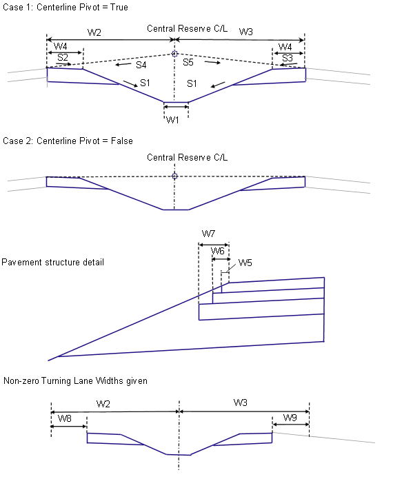

CentralReserveDepressedShoulderExt
This subassembly creates a cross-sectional representation of a depressed central reserve with inside shoulders, using extended termination of shoulder subbase.
It supports superelevation pivoting about the attachment point at the centerline, or about the attachment point level at the inside edges of carriageway. The pavement structure on the paved portions of the shoulder follows the standards described in "Pavement Structure of Paved Sections" in the Autodesk Civil 3D Help.

The attachment point is above the centerline of the ditch. The location of the central reserve links relative to the attachment point varies depending on the pivot method, and in some cases, the central reserve widths and lane slopes. The attachment point is typically placed on the baseline alignment at the design profile level.

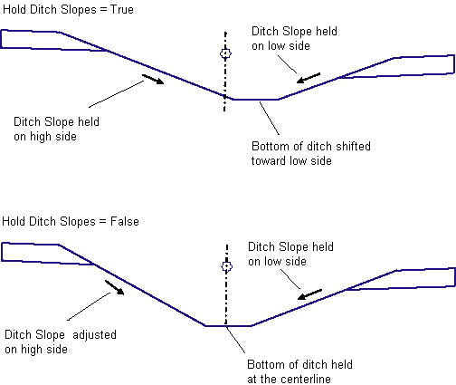

Hold Ditch Slopes
For the cases where the top-of-ditch-slope points are at unequal levels, selects whether to hold the ditch sideslopes and let the position of the ditch shift, or to hold the ditch at the center and adjust the sideslope on the high side
Selection list
Hold ditch sideslopes, shift ditch from center
Centerline Pivot?
Select whether the profile gradient and pivot point is at the centerline above the central reserve ditch, or if it is held at the inside edges of carriageways
Selection list
Pivot about inside edge of carriageway

This subassembly cannot be inserted separately for the left and right sides. It builds the central reserve to both sides of the attachment point.
Superelevation Pivot Point
The central reserve can be configured to have the pivot point at the centerline, or at the inside edges of carriageways. If Centerline Pivot is used, the left and right outside lane superelevation slopes are obtained from the baseline’s superelevation specifications, and the levels of the inside edges of carriageways are calculated by applying these slopes to the left and right central reserve widths from the attachment point. If Centerline Pivot is not used, the edges of carriageways are held to the level of the attachment point.
Ditch Levels and Slopes
Superelevation or turning lanes may cause the top of the ditch slopes to be at different levels on the left and right sides, resulting in an asymmetrical ditch. There are two options for handling this situation. If Hold Ditch Slopes is set to True, then the given ditch slopes are held constant on both sides, which shifts the bottom of ditch away from the centerline towards the lower side. If set to False, the ditch bottom is centered about the central reserve centerline, the given slope is held on the lower side, and the slope is adjusted to match on the higher side.

In layout mode, this subassembly calculates and displays the central reserve and shoulders based on the input parameters given, with lane slopes of -2%, paved shoulder slopes of -5%, and turning lane widths of zero.

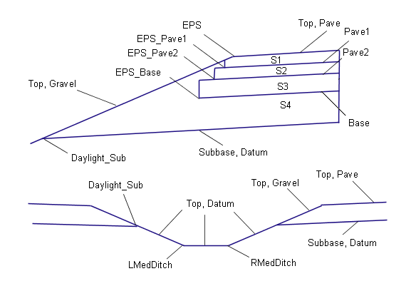

Point, Link, and Shape Codes
The following table lists the point, link and shape codes for this subassembly that have codes assigned to them. Point, link or shape codes for this subassembly that do not have codes assigned are not included in this table.
Point, Link or Shape
Code
Description
Points
As shown below
Links
As shown below
S1
Pave1
S2
Pave2
S3
Base
S4
SubBase
Coding Diagram
