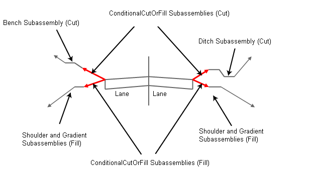

The following illustration shows a corridor assembly section comprised of:

Multiple ConditionalCutOrFill subassemblies may be attached to a common point on an assembly. This includes multiple cut and or multiple fill ConditionalCutOrFill subassemblies, as shown in the following illustration.
This illustration shows only the right side of the assembly. The following table describes the components included on this side of the assembly.
