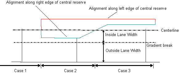

This subassembly inserts one or more travel lanes outward from an alignment that defines the edge of a central reserve.

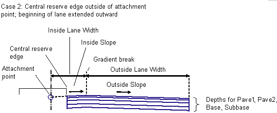

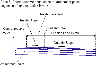

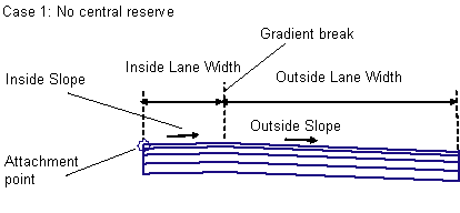

The alignment defining the edge of the central reserve may at times be either not present (Case 1), outside the carriageway centerline (Case 2), or inside the centerline (Case 3).
To use this subassembly, you should have separate alignments defining the left and right edges of the central reserve. It may be necessary to define separate corridor model regions for each individual central reserve. This subassembly differs from LaneFromTaperedCentralReserve1 in that it provides for a gradient break with different slopes in the travel lanes.
The attachment point is at the location where the inside edge of carriageway would be if there was no central reserve. This is typically at the assembly baseline.

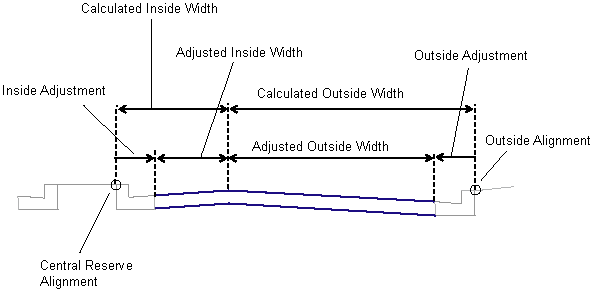

Inside Adjustment |
Used if the Central Reserve Edge alignment is at a fixed offset from the actual edge of carriageway (for example, at the back of kerb). Adjusts the calculated Inside Lane Width to account for the offset (see diagram). |
Numeric, positive |
0.0 |
Outside Adjustment |
Used if the Outside Lane Width alignment is at a fixed offset from the actual edge of carriageway (for example, at the back of kerb). Adjusts the calculated Outside Lane Width to account for the offset (see diagram). |
Numeric, positive |
0.0 |

Gradient Break: The width from the attachment point outwards to the gradient break between the inside and outside lanes can be defined by a fixed numeric width, or an alignment can be used to override the width. The level at the gradient break is determined by applying the specified slope for the inside lane across the width of the lane.
Outside Edge of Carriageway: The width to the outside edge of carriageway can be defined by a fixed numeric width, or an alignment can be used to override the width. The level is determined by applying the specified slope for the width of the lane, unless an Outside Level profile is given. In that case, the outside edge level is tied to the profile, and the slope is adjusted.
Inside Edge of Carriageway: The location of the inside edge of carriageway is calculated based on the three cases shown in the previous diagram. If a Central Reserve Edge alignment is given, and that alignment is outside of the lane’s attachment point, the inside edge is shifted outward from the attachment point at the lane slope (Case 2). If the Central Reserve Edge alignment is inside of the lane’s attachment point, the inside edge is shifted inward from the attachment point at the inside lane slope (Case 3). If no Central Reserve Edge alignment is given, or the given one is not found at a chainage, the inside edge is held at the attachment point (Case 1).
Inside and Outside Adjustments: The Inside Adjustment and Outside Adjustment parameters are provided in case the alignments used for the inside or outside edges are at a fixed offset from the actual edge of carriageway. For example, the alignment being used for the Central Reserve Edge may be at the back-of-kerb instead of at the pavement edge. In this case, the Inside Adjustment parameter should be set to the width of the kerb.
