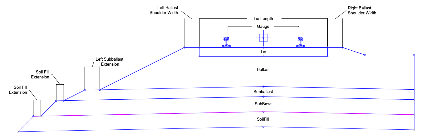

Input Parameters
Note: All dimensions are in metres or feet unless otherwise noted. All slopes are in run-over-rise form (for example, 4 : 1) unless indicated as a percent slope with a “%” sign.
Parameter
Description
Type
Default
Measure Cant at Determines whether the level difference between rails takes place between the gauge line (face) of each rail or CL of each rail. Selection List:
  • Gauge Line to Gauge Line
  • CL Rail to CL Rail
CL Rail to CL Rail
Default Cant The default level difference between rails. The value is positive when the right rail is higher than the left and negative when the right rail is lower than the left. This value is applied in layout mode and is helpful for observing how the subassembly reacts to different cant values. This value is overridden by cant when it is present via the baseline alignment. Numeric 0
Drainage Channel Depth Depth of right drainage channel from top of ballast. Numeric, non-negative
0.5 ft
0.1524 m
Gauge The distance between the inside faces of the rails Numeric, non-negative
56.5"
1435 mm
Rail Head Width Width of the rail head. Numeric, non-negative
2.72"
69 mm
Rail Depth Depth of rail from top of rail to top of tie plate Numeric, non-negative
6.625"
168 mm
Rail Base Width Width of the base of the rail Numeric, non-negative
5.5"
140 mm
Tie Plate Thickness Thickness of the tie plate which is also the distance from the bottom of the rail to the top of the tie. Numeric, non-negative 1"
25 mm
Rail Base to Ballast Distance from the bottom of the rail to the top of the ballast. If this value is equal to the tie plate thickness, then the top of the ballast is flush with the tops of the ties. Numeric, non-negative 1"
25 mm
Tie Length Length of the tie (also known as sleeper). Numeric, non-negative
8.5'
2.59 m
Tie Depth Depth of tie Numeric, non-negative
7"
178 mm
Minimum Ballast Depth The minimum vertical distance between the bottom of the tie and the top of the subballast. The location of this minimum distance changes at different stages in cant. See Behaviour below. Numeric, non-negative 12"
305 mm
Ballast Shoulder Width (Left and Right) The distance from the end of the tie to the beginning of the ballast side slope. Numeric, non-negative 12"
305 mm
Ballast Side Slope (Left and Right) The slope of the sides of the ballast material. The slope of the top of the ballast material matches the slope of the tie that results from cant. Slope, non-negative 2:1
Subballast Depth The depth of the subballast material Numeric, non-negative 8"
203 mm
Subballast Top Slope (Left and Right) The top slope of the left and right sides of the subballast with the centreline of the subassembly as the hinge point. Slope, non-negative 40:1
Subballast Side Slope The slope of the side of the subballast material. Slope, non-negative 2:1
Subbase Extension The distance from the toe of the subballast material to the beginning of the side slope of the subbase material Numeric, non-negative
0.5 ft
0.15 m
Subbase Slope The slope of the sides of the subbase material. Slope, non-negative 1:1
Subbase Depth The depth of the SubBase material Numeric, non-negative
1 ft
0.30 m
Soil Fill Depth The depth of the Soil Fill material Numeric, non-negative
1 ft
0.30 m
Soil Fill Slope The slope of the sides of the soil fill material. Slope, non-negative 1:1
Soil Fill Extension The distance from the toe of the subbase material to the beginning of the side slope of the Soil Fill material Numeric, non-negative
0.5 ft
0.15 m
Omit Rails Prevents the rail points, links and shapes from being drawn. Yes/No No
Omit Tie Prevents the tie points, links and shapes from being drawn. Yes/No No
Omit Ballast Prevents the ballast points, links and shapes from being drawn. If this option is set to Yes then the subballast is also not drawn. Yes/No No
Omit Subballast Prevents the subballast points, links and shapes from being drawn. If the Omit Ballast option is set to Yes then the subballast is not drawn regardless of this setting. Yes/No No
Omit Subbase Prevents the subbase points, links and shapes from being drawn. If the Omit Ballast or subballast option is set to Yes then the Sub Base is not drawn regardless of this setting. Yes/No No
Omit Soil Fill Prevents the soil fill points, links and shapes from being drawn. If the Omit Ballast, subballast, or subbase option is set to Yes then the soil fill is not drawn regardless of this setting. Yes/No No

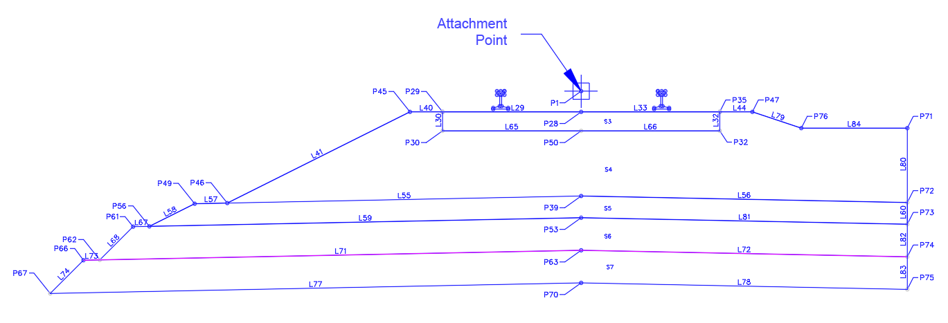

Point, Link and Shape Codes
The following table lists the point, link and shape codes for this subassembly that have codes assigned to them. Point, link, or shape codes for this subassembly that do not have codes assigned are not included in this table.
Point, Link, or Shape
Code
Description
P1, P4-P21 Rail Rail
P2 Cl_Rail Centreline of Rail
P3 Gauge_Line, Rail Gauge line (inside edge of top of rail)
P28-P32, P60 Tie Tie
P45, P54-P55, P47, P71-P72 Ballast Ballast
P50, P53, P73 Subballast Subballast
P63, P65, P74 SubBase SubBase
P68-P70, P75 SoilFill SoilFill
L1, L2 Top_Rail, Rail Top of rail
L3-L28 Rail Rail
L29-L33, L65-66 Tie Tie
L40-L41, L44, L55-L56, L79, L88 Ballast Ballast
L57, L60-L62, L80 Subballast Subballast
L70-L72, L81 SubBase SubBase
L76-L78, L82 SoilFill SoilFill
S1, S2 Rail Rails
S3 Tie Tie
S4 Ballast Ballast
S5 Subballast Subballast
S6 SubBase SubBase
S7 SoilFill SoilFill
