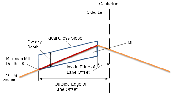

OverlayMill1Lane1Side

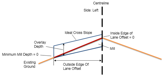

This subassembly overlays one side of an existing road, with a milling layer added as required.
The attachment point is the inside edge point of the overlay layer with finished gradient crossfall.

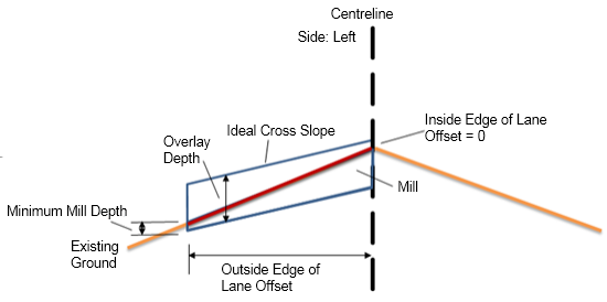

Overlay Depth Depth of the overlay layer. Numeric 0.300m

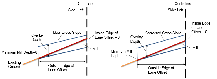

Overlay Slope Options Specifies overlay slope options.
Tip: Flapping is a term used to describe how the corrected cross slope for an overlay in a rehab subassembly is calculated. Flapping outcomes are different, relative to the slope tolerance and the slope difference between existing ground cross slope and ideal cross slope. If the slope difference is less than the slope tolerance for the subassembly, then the use case is considered "within tolerance". If the slope difference is greater than the slope tolerance for the subassembly, then the use case is considered "outside of tolerance".
Note: Slope tolerance is an absolute value. Therefore, for either a slope difference of 0.4% or -0.4%, both have an absolute value of 0.4%. If the slope tolerance is 0.5%, the 0.4% absolute slope difference would be considered within tolerance.
  • User Defined with Flapping
    Flapping specifies how the corrected cross slope will be calculated, relative to the slope tolerance for the subassembly.
    • Flapping Within Tolerance:
      The corrected cross slope will be the existing ground cross slope.
    • Flapping Outside of Tolerance:
      The corrected cross slope will vary and will be the existing ground cross slope plus or minus the slope tolerance value.
      Note: Whether the slope tolerance is added or subtracted depends on which one will bring the values of the existing ground cross slope and the ideal cross slope closer together.
  • User Defined Without Flapping
    Flapping specifies how the corrected cross slope will be calculated, relative to slope tolerance for the subassembly.
      The corrected cross slope will be set equal to the ideal cross slope.
      The corrected cross slope will be the ideal cross slope plus or minus the slope tolerance value.

  • Match Slope
    The corrected cross slope is always set equal to Existing Ground Slope.
  • Use Ideal Crossfall
    The corrected cross slope is always set equal to Ideal Cross slope.

Ideal Crossfall Specifies user defined ideal crossfall. Numeric -2.00%
Lane Width The lane width, determined by the offset of the outside edge of lane from the inside edge of lane. Numeric 12.000m
Use Profile Options Select to tie the inside edge of overlay to a profile, adjust level to minimum level depth lock to preceding subassembly.
  • Minimum Level Depth
    The crossfall and level adjustments will meet Minimum Level and/or Minimum Mill Depth. The base is the existing surface.
  • Use Profile
    There will be no level adjustment. The level of the rehab subassembly attachment point will match the assigned profile. The crossfall adjustment will be determined by Overlay Slope Options.
  • Lock to Preceding
    There will be no level adjustment. The level of the rehab subassembly attachment point will match the attachment point of the preceding subassembly (in most cases this will be the preceding lane's end point). The crossfall adjustment will be determined by Overlay Slope Options.
User Defined Minimum Mill Depth
Minimum Mill Depth The minimum mill depth between the bottom of the milling layer to the bottom of the existing ground layer. Numeric 0.300m

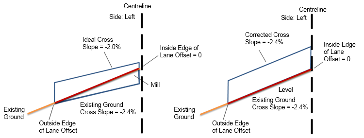

This subassembly assumes that no levelling layer is added.

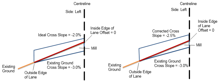

Case 1
Inputs:
Inputs
Ideal Crossfall -2.0%
Minimum Mill Depth 0
Slope Tolerance 0.50%
Overlay Slope Options User Defined with Flapping
Use Profile Options Minimum Mill Depth
Calculations:
Input Value
Existing Ground Crossfall -3.0%
Existing Ground Crossfall – Ideal Crossfall 1.0%
Slope Tolerance Existing Ground Slope minus Ideal Crossfall is 1%, which is greater than the 0.5% Slope Tolerance
Corrected Crossfall The Corrected Cross slope will be -2.5%
Output Value
Corrected Crossfall -2.5%
Case 2
Inputs:
Inputs
Calculations:
Input Value
Existing Ground Crossfall -2.4%
Existing Ground Crossfall – Ideal Crossfall -0.4%
Slope Tolerance Existing Ground Slope minus Ideal Cross slope is 0.4%, which is less than the 0.5% Slope Tolerance.
Corrected Crossfall The Corrected Cross slope will be -2.4%
Output Value
Corrected Crossfall -2.4%

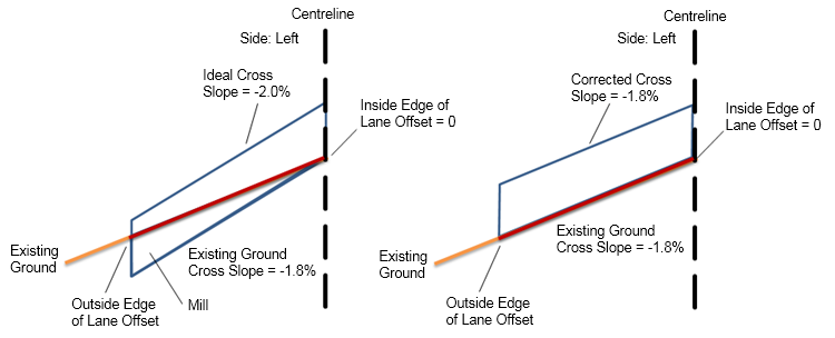

Case 3
Inputs
Calculations:
Input Value
Existing Ground Crossfall -1.8%
Existing Ground Crossfall – Ideal Crossfall 0.2%
Slope Tolerance Existing Ground Slope minus Ideal Crossfall is 0.2%, which is less than the 0.5% Slope Tolerance
Corrected Crossfall The Corrected Cross slope will be -1.8%
Output Value
Corrected Crossfall -1.8%

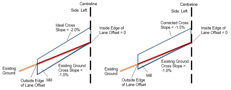

Case 4
Inputs
Calculations:
Input Value
Existing Ground Crossfall -1.0%
Existing Ground Crossfall – Ideal Crossfall 1%
Corrected Crossfall The Corrected Cross slope will be -1.5%
Output Value
Corrected Crossfall -1.5%
