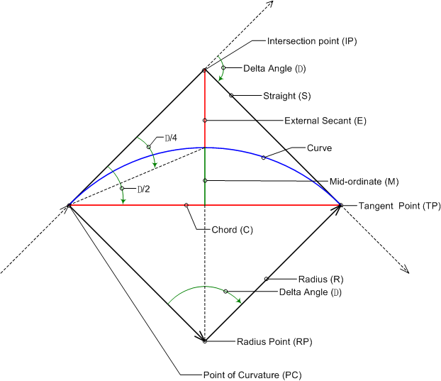

The following illustration shows the curve parameters used by Autodesk Civil 3D

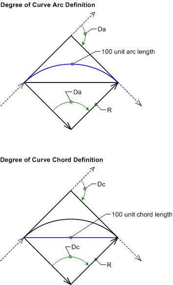

- Degree Of Curvature Definition
Specifies whether the degree of curvature will be based on the arc or the chord.
- Chord Definition: Specifies that the degree of curvature is determined by the chord. Use this option if the curve is a railway curve. For a railway curve, the degree of curvature is the angle at the center of a circular curve subtended by a chord of 100 units.
- Arc Definition: Specifies that the degree of curvature is determined by the arc. Use this option if the curve is a carriageway curve. For a carriageway curve, the degree of curve is the central angle subtended by a circular arc of 100 units.
The following illustration shows the degree of curve definition for arcs and chords.

- Delta Angle
Specifies the delta angle of the curve. This option is not adjustible if Delta Angle is specified as the Fixed Property.
- Radius
Specifies the radius of the curve. This option is not adjustible if Radius is specified as the Fixed Property.
- Straight Distance
Specifies the straight length of the curve.
- Arc Distance
Specifies the arc length of the curve.
- Chord Distance
Specifies the chord length of the curve.
- External Distance
Specifies the external secant length of the curve.
- Mid-ordinate Distance
Specifies the mid-ordinate length of the curve.
