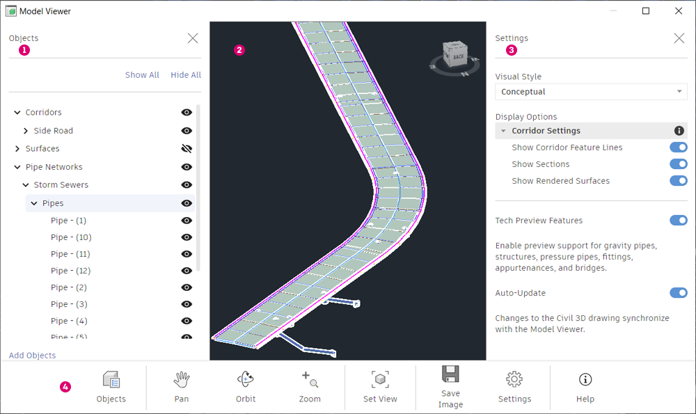

This will open the Model Viewer. Add more objects to preview and adjust how they are displayed.
  1. Objects Panel. Lists the selected objects for the Model Viewer and specifies their visibility. The panel is displayed or hidden by clicking Objects in the Viewer Toolbar. For more information, see Civil 3D Model Viewer Objects Panel.
  2. Viewer 3D Canvas. Displays your drawing as a model in this space. Hide or display specific objects in the Objects Panel and navigate perspective from the Viewer Toolbar.
  3. Settings Panel. Supplies visual display styles and other Civil 3D Model Viewer settings. The panel is displayed or hidden by clicking Settings in the Viewer Toolbar. For more information, see Civil 3D Model Viewer Settings Panel.
  4. Viewer Toolbar. Enables navigation and perspective views in the 3D Canvas. You can pan, orbit, zoom, and take screenshots of the current view. For more information, see Civil 3D Model Viewer Navigation.
