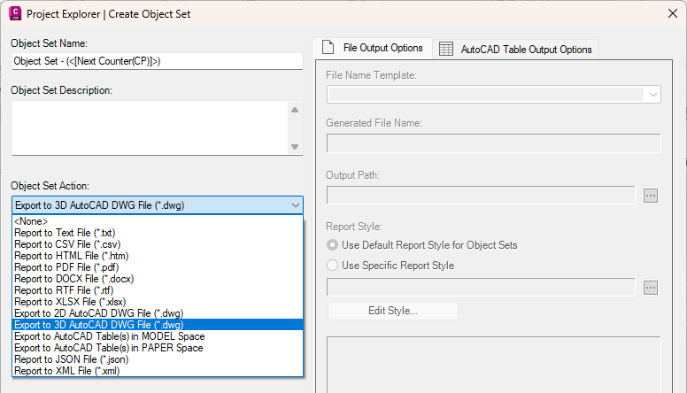

New in 2026.2
Added the ability to export 3D AutoCAD DWG files.
This option is available to the following:
- Object Set Actions list in the Create Object Set dialog box.
- Quick Report/Export context menus for all object types in Project Explorer.
- AeccRunProjectExplorerActions command.
Learn more.

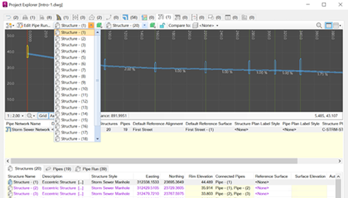

New in 2026.1
- Added pick buttons to select start and end structures from a pipe network from the viewport. Start and end structures can still be selected from their appropriate drop-down menus.
- Improved the ability to easily scroll through long lists of structures when selecting a start and end structure for the profile view in the Pipe Networks tab.
- Added new items to the context menu in the Structures List view that allow any selected structure to be assigned to the Pipe Network View as a Start or End Structure. Right-clicking a structure now offers the following additional options:
- Assign to Pipe Network View Start Structure
- Assign to Pipe Network View End Structure.

- Added support to export XML data files.
- ‘XML files’ added to the drop-down list of file types in the Create Quick Report dialog.
- ‘Report to XML File’ added to the drop-down Object Set Action list in the Create Object Set dialog box.

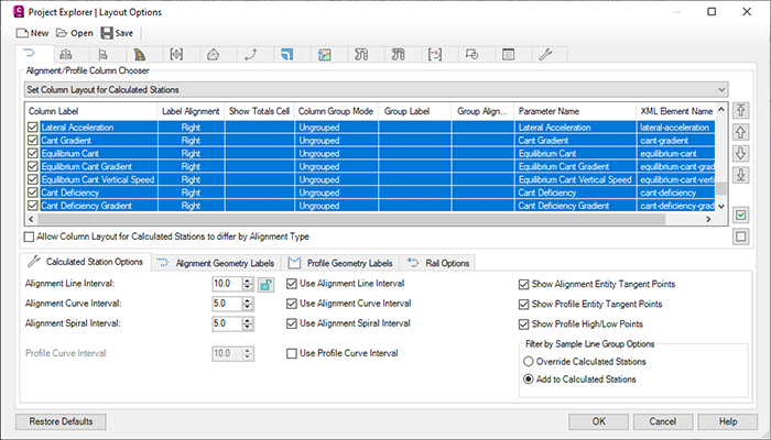

New in 2026
Rail CANT Information
- The following Rail CANT values have been added to the calculated stations list and are available as reports and tables.
- LateralAcceleration
- CantGradient
- EquilibriumCant
- EquilibriumCantGradient
- EquilibriumCantVerticalSpeed
- CantDeficiency
- CantDeficiencyGradient
- CantDeficiencyVerticalSpeed
- CantRatio
- CantJerk
- VerticalSpeed
