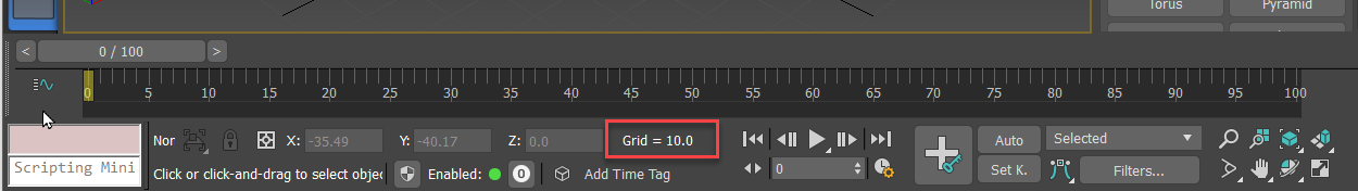

The grid setting display shows the size of one grid square.
This value is constant in the active viewport. It does not change if you zoom in very close or zoom out very far.
To change the size of one grid square:
Grid and Snaps
Grid And Snap Settings.
The new value is displayed in the grid setting display.
