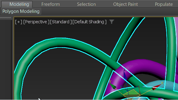

You can quickly access various statistics related to your current selection and entire scene.
To use the viewport statistics display:
Viewport Configuration dialog
Statistics panel.
Show Statistics.
You can customize the viewport statistics by turning on and off options on the Statistics panel of the Viewport Configuration dialog. The following statistics reflect all options turned on.
The first column lists the statistics for the entire scene, while the second only refers to the selected objects.
