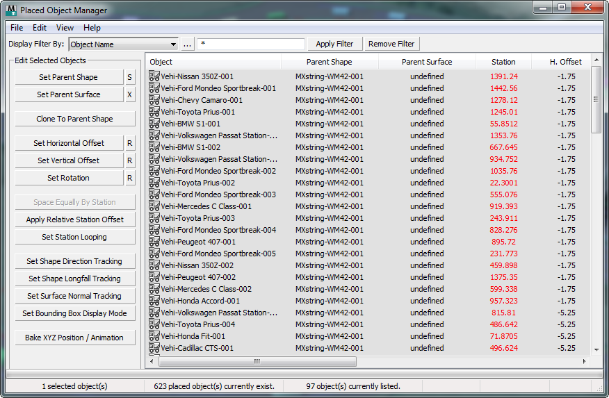

The Placed Object Manager panel controls the position parameters of multiple placed objects.
The panel provides a full overview of all objects placed into the current scene from the Civil View
Object Placement Style Editor. This panel allows you to:
- Collectively update position parameters for any combination of objects.
For example, you can change the horizontal offset of all lamp columns in a single operation.
- Sort the list in ascending or descending order based on the contents of any column by clicking any column header.
- Filter the contents of the object list based on an individual parent shape, parent surface, object category, or object name mask.
- Limit the total number of objects listed for complex scenes.
The default is 1000 objects. The status bar on this panel shows the total number of objects in the scene and the number of objects listed.
- Clone any selection of placed objects from one parent shape to another.
- Access Quick Animation Tools to apply, remove, scale, or reverse animation to any selection of placed objects.
- Randomize the horizontal offset of any selection of animated vehicles.
You can set minimum and maximum values to prevent vehicles from always driving exactly in the center of each driving lane.
- Bake the animation currently applied to any selection of placed objects.

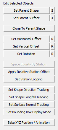

Edit Selected Objects group
Controls in this group edit the settings of objects selected in the main object list.
- Set Parent Shape
- The position of an object is specified by the path of its parent shape. Click Set Parent Shape to change the parent shape, then select the new shape in a viewport. The objects move to a new position based on the new parent.
- "S" button Click to change the spline index of the placed object, relative to the parent shape.
- Set Parent Surface
- Click this button to assign a parent surface to the selected objects, then select the surface in a viewport.
As well as following the path of a shape, objects can also track surface terrain. This effectively overrides the basic Z value (or object height) derived from the parent shape. This ensures that objects always sit perfectly on a ground surface, but use this feature sparingly: It can have a severe effect on the performance of 3ds Max, particularly with animated objects.
- "X" button Click to remove the parent surface assignment.
- Clone To Parent Shape
- Click to clone a selection of objects to another parent shape, then select the new parent shape in a viewport.
- Set Horizontal Offset / Set Vertical Offset / Set Rotation
- Use these buttons to assign a new constant horizontal or vertical offset or rotation value to the selected objects.
- Space Equally By Station
- Click to space the selected objects equally along their parent shape.
The selected objects become equally spaced between the objects in the selection that are currently nearest to the start and end of the parent shape.
This button is disabled if two objects or fewer are selected.
- Apply Relative Station Offset
- Click to offset the position of the selected objects, relative to their parent shape, by a constant value.
For example, to move a series of lamp columns 5 meters closer to the beginning of the parent shape, enter a value of
–5.0.

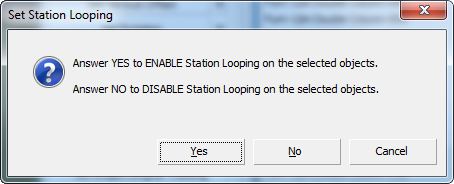

- Set Station Looping
- Click to enable or disable station looping for the selected objects.
Station looping forces animated objects to return to the start of their parent shape when they reach the end of an animation sequence.

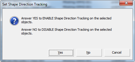

- Set Shape Direction Tracking
- Click to enable or disable shape direction tracking for the selected objects.
When
shape direction tracking is on, an object rotates about its insertion point to follow the tangent of the parent shape.

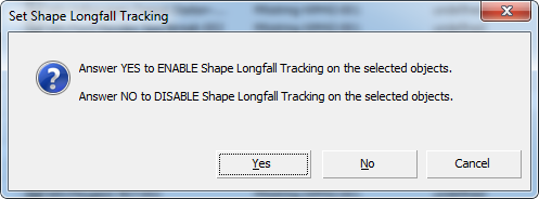

- Set Shape Longfall Tracking
- Click to enable or disable shape longfall tracking for the selected objects.
When
shape longfall tracking is on, an object tilts about its insertion point to take account of the vertical slope of the parent shape. When longfall tracking is off, the object always remains horizontal.
This parameter is ignored if Surface Normal Tracking is on (see below).
- Set Surface Normal Tracking
- Click to enable or disable surface normal tracking for the selected objects.
When
surface normal tracking is on, an object tilts about its insertion point to match the overall slope of the underlying surface.
This parameter is ignored if the object has no parent surface specified.
- Set Bounding Box Display Mode
- Click to enable or disable bounding box display for the selected objects.
Bounding box display can improve viewport performance.

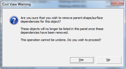

- Bake XYZ Position / Animation
Click to remove the standard Civil View position controller from the selected objects. Objects are baked into their XYZ location; or if they are animated, the animation becomes keyframed.
Baking animation can dramatically improve the performance of playing back animation in the 3ds Max viewports; on the other hand, you lose all parent shape/surface dependencies, so subsequenly changing the shape or surface does not update the position or animation of the baked objects. In addition, this operation cannot be undone. When you click this button, Civil View displays a warning to this effect:
[object list]
Lists objects in the scene. You can filter the list to show only certain objects.
Click an object in the list to select it. To select multiple objects, use
Ctrl+click; use
Shift+click to select contiguous entries.
Clicking a column heading lists contents in ascending or descending alphabetical order. By default the order is ascending alphabetical.
Animated parameters are shown in red.
