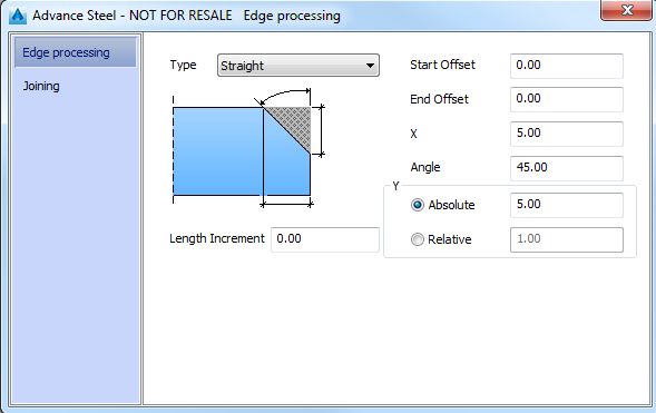

Learn how you can modify the weld preparation properties for corner and bevel cuts.
Corner Cut Edge Processing
| Type

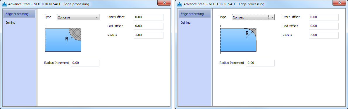

Defines the shape of the weld preparation. The following options are available:
| Straight: Creates a chamfered weld preparation.
| Convex: Creates a convex fillet weld preparation.
| Concave: Creates a concave fillet weld preparation.
| Radius
Defines the fillet radius.

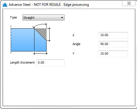

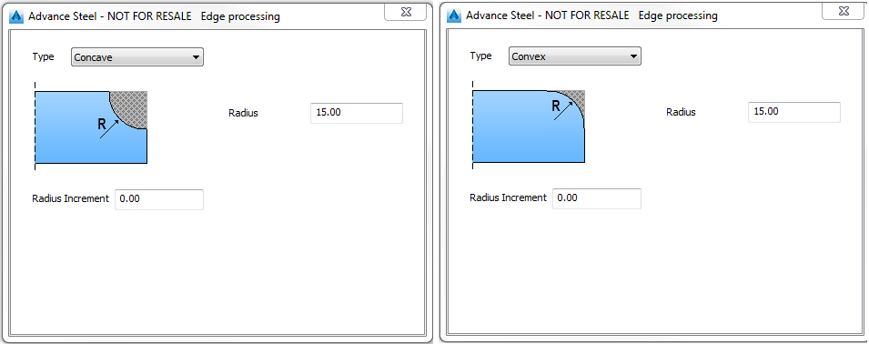

Bevel Cut Edge Processing
| Type
| Radius
