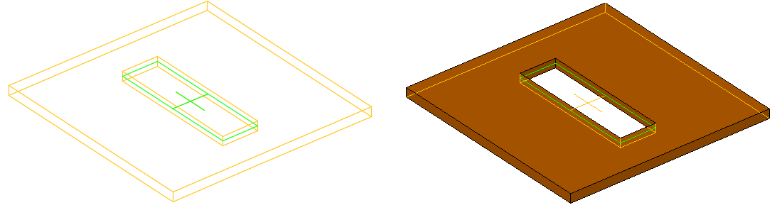

Cut rectangular contours from a plate, defined by the center point.
The cuts can be attached as inner contours as well as outer contours. The rectangle size is set by the defaults.
