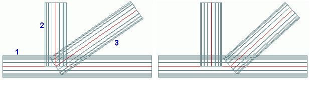

Using this command you can define the desired gap between two beams. The beams are automatically offset.
The tool is useful for designing trusses.
