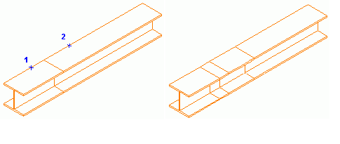

Split a beam
Beams panel, click
(Split beams).
Split several beams
Beams panel, click
(Split beams).
Split beams with a gap
Beams panel, click
(Split beams).
