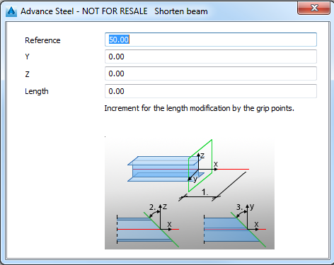

Use the parameters on this tab to modify the beam length or to create a diagonal cut.
| Reference | Defines the shortening (or lengthening) size. A positive value trims the beam and a negative value extends the beam. |
| Y | Defines the rotation angle around the main Y-axis of the beam. |
| Z | Defines the rotation angle around the main Z-axis of the beam. |
| Length | Defines the length increment (grid jump) when modifying the shortening position using the grip points. |
