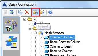

You can import settings on any machine running the same Advance Steel version, by using the Import command located on the Quick Connection dialog toolbar.
